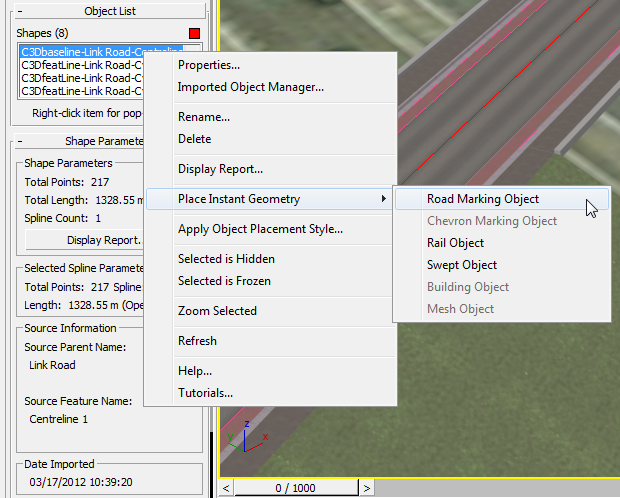

Create a marking for the center line:
- If the Civil View Explorer is not already open, choose Civil View menu
Civil View Explorer.
- On the Scene Explorer, select the centerline of the road, C3Dbaseline-Link Road-Centreline 1.
Tip: By default, the Scene Explorer panel appears to the left of the viewports, but if it has been hidden, you can press the H key to display a floating version of the Explorer.
On the Civil View Explorer, the lower panel now shows an Object List rollout for imported shape objects. The C3Dbaseline-Link Road-Centreline 1 is highlighted.
- Right-click the highlighted centerline entry, and from the pop-up menu choose Place Instant Geometry
Road Marking Object.
3ds Max Design adds a continuous centerline to the roadway, which you can partially see in the viewport.

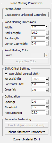

- On the Civil View Explorer, scroll so you can see all of the Road Marking Parameters rollout.
- In the Road Markings rollout
Road Marking Dimensions group, change the settings as follows: - Mark Length: 3.0
- Gap Length: 7.0
The viewport updates to show these changes.

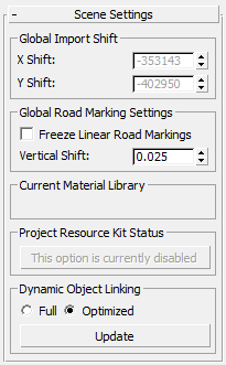

The reason some of the centerline marking seems to be missing in the viewport, is that you need to adjust the vertical offset for road markings.
upper panel (the Civil View Explorer rollout), click the Scene Settings entry.
In the lower panel, the Civil View Explorer opens the Scene Settings rollout.
- In the Scene Settings rollout
Global Road Marking Settings group, change the Vertical Shift value to 0.05. Now all the road markings are visible.
Note: You can also set the Vertical Shift locally, for individual road-marking objects, but in general it is best to set it for the scene as a whole.
