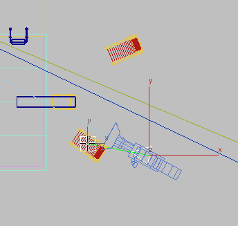

  3. On the Create panel, activate (Helpers). On the Object type rollout, click to activate Tape.
    You will use the Tape helper to determine the distance between the camera and three objects in the scene: a chair, a flower pot, and a corner of the building. The location of each object will become a focal plane, or region where the scene is in the sharpest focus.
  4. Click on the center of the camera object and drag to the closest chair, as shown in the next illustration.
    On the Parameters rollout, the Length field displays the distance between the two objects as roughly 2.3 meters.
