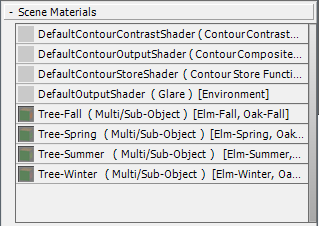

  2. On the Material/Map Browser panel at the left, scroll down so you can see the Scene Materials group. (It helps to drag the edge of the Browser panel to make the Browser wider, too.)
    The four Tree materials are the ones you want to save.

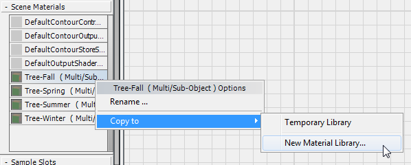

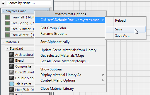

  3. In the Scene Materials group, right-click the Tree-Fall material entry. On the pop-up menu, choose Copy To New Material Library.
    In the file dialog, name the library mytrees.mat.
    3ds Max displays an entry for the new library at the top of the Material/Map Browser.
    The asterisk before the name of the library indicates that it has not yet been saved.

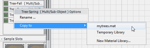

  4. In the Scene Materials group, right-click the Tree-Spring material entry. On the pop-up menu, choose Copy To mytrees.mat.
  5. Copy Tree-Summer and Tree-Winter to mytrees.mat as well.
  6. Scroll to the top of the Material/Map Browser so you can see the mytrees.mat library. Right-click the mytrees.mat label, and on the pop-up menu, choose the first entry, C:\Users\...\mytrees.mat Save.

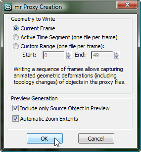

    3ds Max opens a file dialog. If you need to, navigate to the \sceneassets\renderassets folder. Name the file My_Elm_Winter (it has a file name extension of MIB), and then click Save.
    3ds Max opens an “mr Proxy Creation” dialog. On this dialog, click OK to accept the default values.
    Note: If your tree object were animated, you would use the “mr Proxy Creation” dialog to save the object as a sequence of frames, with one .mib file created per frame. You specify the time segment to save in the Geometry To Write group.

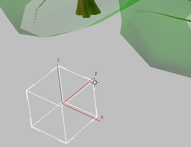

    3ds Max briefly displays a small Rendered Frame Window while it renders the proxy geometry.
    In the viewport, 3ds Max displays the mr Proxy object as a point cloud.

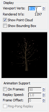

  6. In the Parameters rollout Display group, change the Viewport Verts value from 128 to 512, and press .
    The object outline becomes more apparent as more points are displayed, but a denser point cloud can affect viewport performance.

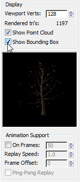

  7. Change the Viewport Verts value back to 128, then turn on Show Bounding Box to display the extents of the tree proxy.
    3ds Max displays the proxy surrounded by a complete bounding box.
