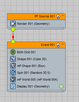

  1. Start or reset 3ds Max, press 6 to open Particle View, and then drag the mParticles Flow from the depot to the event display.
    This adds in one fell swoop all the necessary elements for a simple physics simulation.

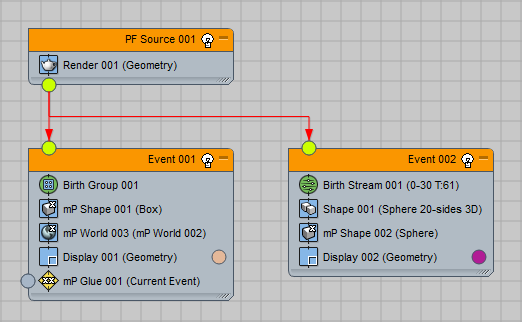

  1. From the depot, drag a Birth Stream operator next to Event 001 so it creates a new event. Set the Display operator to Geometry, and then add a Shape operator and a mParticles Shape operator after Birth Stream, both set to Sphere. Wire the event to the PF Source global event.
    Important: Makes sure the Shape operator precedes the mParticles Shape operator in the event. Because event elements are handled in order from top to bottom, the Shape data must be available for mParticles Shape to process; otherwise it won't work correctly.
    You also need to clone the mParticles World operator so both events use the same mParticles World helper and world setup. You'll do this in a little while.
  2. Click the Birth Stream operator and set Emit Stop to 0, so that all particles are emitted at once at the start of the animation.
    The read-only Total field should now contain 1.
    If you play the animation now, you see the single particle come shooting out from under the wall. That's because the default position of the Birth Stream icon is at the world center: (0,0,0). Also, because Birth Stream has a Speed property built in, set to 300 by default, no additional Speed operator is necessary.

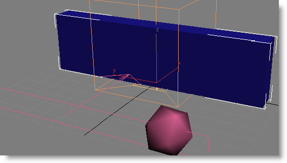

  3. Select the Birth Stream icon and move it about 80 units in the negative X direction, and then move it upward so it's vertically centered on the wall height. The position should be about (–80,0,15).
  4. Rotate the Birth Stream icon –90 degrees along the Y axis, so the vector arrow points at the wall.
  5. Click the Shape operator and set the Size to 20 to increase the size of the sphere.
  6. Play the animation.
    The sphere goes through the wall without colliding with the bricks. That's because its event isn't participating in the physics simulation yet.
    An mParticles World operator needs to be in every event whose particles participate in the simulation. It should always be the last operator in the event except for Display and any tests.
  7. In Event 001, right-click the mP World 01 event and choose Copy. Then right-click Event 002 and choose Paste.
    3ds Max adds an mParticles World event to the sphere event.
  8. If the new mParticles World event is not at the bottom of Event 002, just above the Display operator, drag and drop it to correct the position.
    Note: You don't need to use Paste Instanced because there is never more than a single mParticles World operator in a scene: Events that use this operator are part of the same simulation, and changing the mParticles World parameters from one event updates the same parameter settings for all events that include mParticles World.

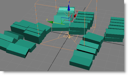

    This time the sphere knocks the wall down. Depending on your setup, it might also then push the wall along as it rolls. The particles remain bound together tightly even when struck by the ball.
    If the ball doesn't knock over the wall at first, try selecting mParticles World and reducing the Apply Gravity Acceleration value; for example, to 245. You can also save your work and take a look at the included file pflow_mparticles_tutorial.max. Check its settings to see what's different from your setup.

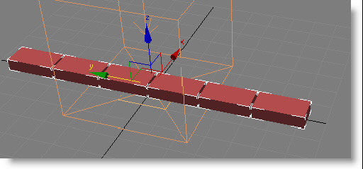

Another useful mParticles Glue option is Bind Center Aligned Only. This creates bindings that are based on particle alignment as well as proximity. With the current arrangement of particle bricks, this would be difficult to see because each brick is aligned with its neighbors, so you'll rearrange the layers slightly.
  1. Click to highlight the Event 001 Birth Group operator and then click Unhide to reveal all the mesh shapes used to generate the particles. Then turn off the Birth Group operator so you can see the boxes more easily.
  2. Starting with the bottom row, select each alternating row of boxes, then move them about 10 units to the right so each brick is offset from its vertical neighbor by half its length.

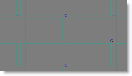

  6. Turn on Bind Center Aligned Only.
    This eliminates all the diagonal bindings by allowing mParticles Glue to bind only to particles whose local axes are aligned with each other. So bindings can go only at right angles (the way the axes line up), not diagonally.
    If you look closely, you can see the horizontal bindings between neighboring particles and the vertical bindings between particles in alternating layers. To create the plank effect, you use a third setting to eliminate the latter.
  7. Turn on Bind Gap.
    Bind Gap eliminates bindings beyond the specified distance, so the long-distance bindings between alternating vertical layers, which are much longer than the specified Bind Gap value of 1.0, are no longer enabled. You're left with horizontal bindings only, which provide the desired plank effect.
    After you turn on Bind Gap, if you don't see the small horizontal bindings between boxes, increase the Bind Gap value until the bindings reappear.

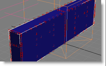

  8. Create a Box primitive that fits snugly around the brick wall. Set Length Segs and Height Segs both to 20, and Width Segs to 5.
    In the included sample scene, pflow_mparticles_tutorial.max, the size is 127 x 12 x 34, but this might vary in your scene.

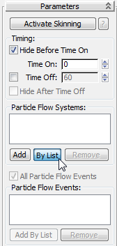

  9. Apply the Particle Skinner modifier to the box.
  10. On the modifier Parameters rollout, under Particle Flow Systems, click By List.
    On the Select Particle System dialog, click to select PF Source 01, and then click OK.
    The Particle Flow Systems list now contains a single entry: PF Source001. However, not all the particles in this system should affect the box "skin"; just the ones in Event 001.
  11. In the Particle Flow Systems group, turn off All Particle Flow Events. Then click Add By List and select Event 01.

  13. Turn on Activate Skinning at the top of the Parameters rollout, and then scroll down to the Display Parameters rollout, expand it, and turn on Display Unassigned Points.
  14. Back on the Parameters rollout, in the Distance Influence group, note that the Absolute option is active. Use the spinner to lower the Absolute value until you see small red squares on the box, as depicted in the following illustration (these indicate mesh points that aren't influenced by any particles), and then increase it until you don't see any more from any angle. A value of 7 should be about right.
    Tip: You can see the number of unassigned points on the Activate Skinning Info dialog, which you open by clicking the ? button next to the Activate Skinning button.
  15. Also, in the Rip Surface Apart group, just below the Distance Influence group, set Type to Distance Change.
    Now that the basic setup is finished, you don't need to see the "brick" particles anymore.
  16. Click the Display operator in Event 001 and set Type to None.
  17. Play the animation.
    As the ball particles strike the now-invisible particles, they break up and take the skinned-box mesh with them, ripping it apart based on the distances traveled by the particles. However, the ripping isn't perfect; a few of the mesh faces just stretch out, spoiling the effect somewhat.
    The remedy is simple: Just make the ripping more sensitive to the change in distance between particles.
  18. The Distance Change Relative% setting is currently 50.0, the default. Change this to 1.0.
    That way a relatively small change in distance causes the mesh to rip.
  19. Play the animation.
    This time the pieces break cleanly, with nicely jagged edges for realism.
    If you prefer a straighter edge, try reducing the Edge Split Precision Relative% value.
    You might notice that the pieces don't seem very solid, as you can see through the inside surfaces. This can be remedied with a standard modifier.
  20. Apply a Shell modifier to the box, above the Particle Skinner modifier, and set the Inner Amount to 2.0 and the Outer Amount to 1.0.
    Now when you play the animation, the pieces look more realistic.
    Tip: If you want to render the animation, first set the Render operator in the PF Source event to Type=Phantom, so the particles don't render.
