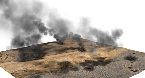

Particle systems can model snow and rain, flowing water, smoke, explosions, and so on. Typically they give you animated effects.
In this tutorial, you use the Particle Flow particle system to model smoke on a bombing range or battlefield.
