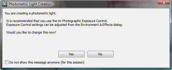

    3ds Max opens a dialog that asks whether to add an “mr Photographic Exposure Control” to the scene.
  4. Click Yes to add the exposure control.

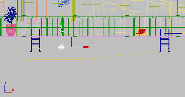

  7. Right-click the Front viewport, zoom in so you can see the light fixture socket and the new light object, and use (Select And Move) to move the light object on its Y axis until it is positioned inside the fixture.

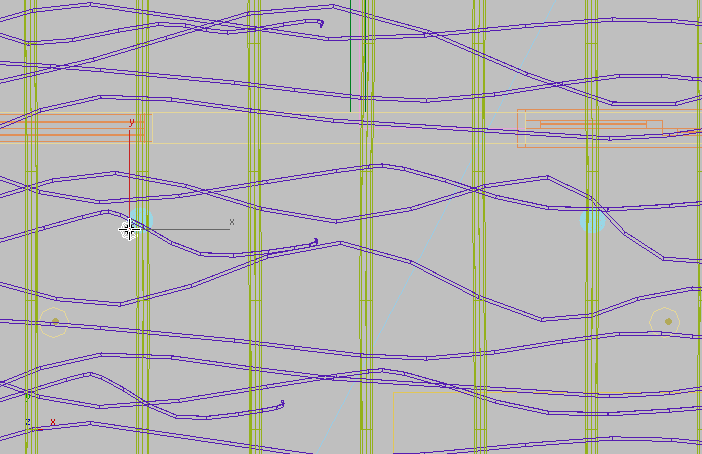

Add the other porch lights:
  1. In the Front viewport, pan and zoom out until you can see the porch light fixtures to the right of the light you just created.
  2. Activate (Select And Move), then +drag a copy of the Free Light along its X axis until it is inside the neighboring socket, as shown in the next illustration.
    3ds Max opens a Clone Options dialog. In the dialog Object group, choose Instance. Set the Number Of Copies to 2, and then click OK.
    3ds Max adds the other two porch lights. The third light has the same spacing you gave to the scond, so it lines up with the socket at the right.

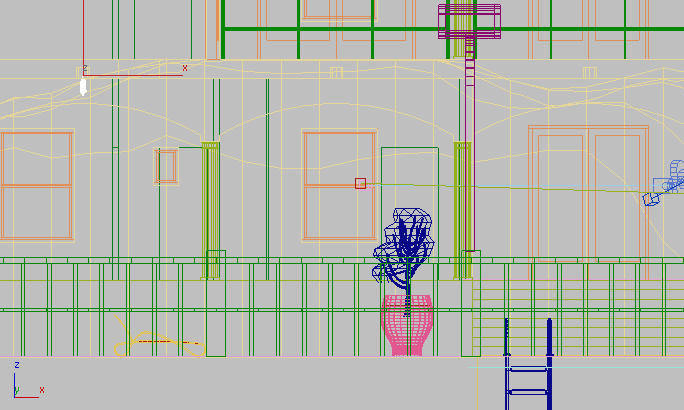

Add lights to the balcony:

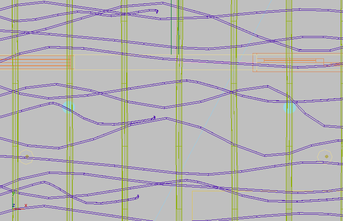

  1. Activate the Top viewport again and zoom in closely on the balcony area.
    There are two blue light fixtures over the balcony: ConeLightBulb01 and ConeLightBulb02.
  2. On the Create panel, activate (Lights). On the Object Type rollout, click Free Light to activate it.
  3. Click in the neighborhood of ConeLightBulb01 to place the light. The exact position is not important.

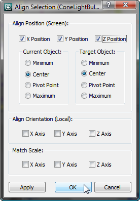

  4. On the main toolbar, click (Align), then click ConeLightBulb01.
  5. In the Align Selection dialog Align Selection (Screen) group, turn on X, Y, and Z Position, then choose Center for both Current Object and Target Object. Click OK.
    This aligns the center of the light object with the light fixture.
    Keep in mind that because the light is set to cast shadows, the object it is placed in must have a material transparent enough for light to pass through. Otherwise, rays from the light object will strike the inside of the object it is enclosed in, and travel no farther.
  6. Go to the Modify panel Templates rollout and choose 100W Bulb.
    Keep in mind that the light you choose in this list possesses the same properties as a real-world light, and must therefore be appropriate for the area it is intended to illuminate. In terms of light attenuation, for example, for every 10 meters distance travelled, light intensity from this 100-Watt bulb will drop off to 1/100th of its initial strength.
  7. On the Intensity/Color/Attenuation rollout, choose the Kelvin (color temperature) option to change the light color to a soft yellow (2800K).
  8. Activate (Select And Move), +drag to copy the light to a position near ConeLightBulb02.
    In the Clone Options dialog, make sure Instance is chosen, then click OK.
  9. Align the cloned light object just as you did the first light object.

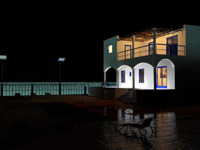

Render the scene again to see the result:
  1. Restore the Rendered Frame Window, then make a clone of the currently rendered frame.
  2. Activate the Camera-Terrace viewport, then render the scene.
    Compare the two rendered images.
    Because you used a yellow color (2800K) for the 100W bulb light objects, the upper balcony is bathed in a yellowish light. Also, now light is visible from the door and windows of the two rooms that have lights inside them.

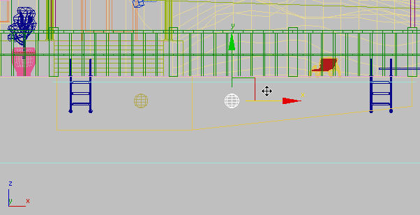

Add halogen lights to the pool:

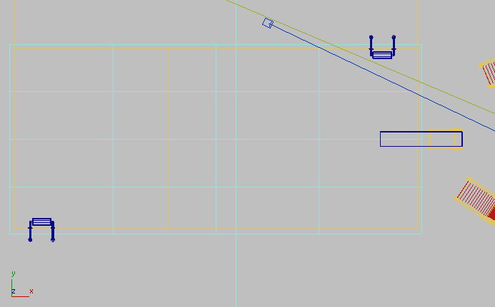

  1. Activate the Top viewport, then zoom and pan so you can see the swimming pool, as shown in the next illustration.
  3. Click once to place a light object at the inner edge of the pool on the upper-left side, as shown in the next illustration. Right-click to end object creation.
    Be sure to position the light so it is slightly away from the pool wall.
  4. Activate the Front viewport, pan so you can see the swimming pool, then use (Select And Move) to move the light object on its Y axis until it is positioned at the midpoint between the floor of the pool and the waterline.
  5. Go to the Modify panel. On the Templates rollout, open the drop-down list and choose 80W Halogen Bulb.
    The default color for this type of light is 2900 degrees Kelvin, which produces a yellowish hue. A whitish-blue color is preferable, so now you will modify the light’s Kelvin value accordingly.
  6. In the Intensity/Color/Attenuation rollout Color group, make sure Kelvin is chosen, then set the Kelvin value to 8000.0.

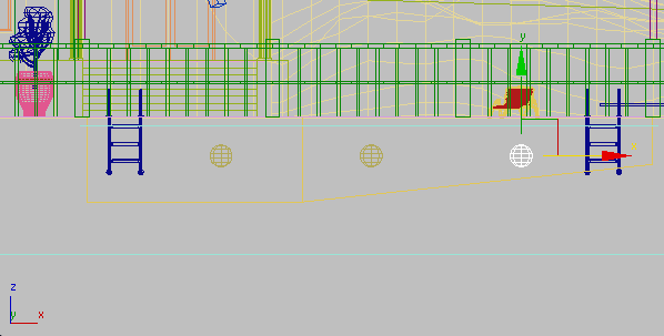

  7. In the Front viewport, +move the light to place the new light about halfway along the length of the pool.
    In the Clone Options dialog, make sure Instance is chosen, then increase the Number Of Copies to 2. Click OK.
    3ds Max adds two new lights, spaced equally apart.
  8. Activate the Top viewport. +click to select all three light objects, then +move them to place copies at the opposite side of the pool (leave a bit of distance between the lights and the side of the pool).
    In the Clone Options dialog, make sure Instance is chosen and Number Of Copies equals 1, then click OK.
Render the villa with pool lighting:
  2. Activate the Camera-Terrace viewport, render the scene, then compare the two renderings.
    The scene is starting to take shape. Your next task will be to add light objects to the lamp posts that surround the pool.
