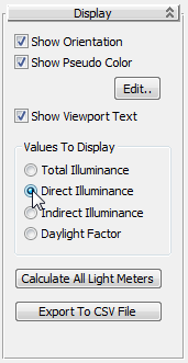

  4. Go to the Modify panel and in the Display rollout Values To Display group, choose Direct Illuminance.
    The sample points all return a value of 0 because, being an overcast day, there is no direct sunlight to record.

  5. Choose Indirect Illuminance.
    The values are identical to those of step 2, because Total Illuminance measured no direct sunlight.
  6. Choose Daylight Factor.
    Light meter readings showing Daylight Factor
    The values show the percent of outdoor sun striking the area occupied by each sample point. The values from 5.2 to 6.5 returned by the sample points at the lower right of the viewport equal roughly five to six and a half percent of the 10,000 lux value of estimated outdoor horizontal diffuse light intensity you set earlier. If you choose the Total Illuminance option again, that percentage value is expressed in lux units.

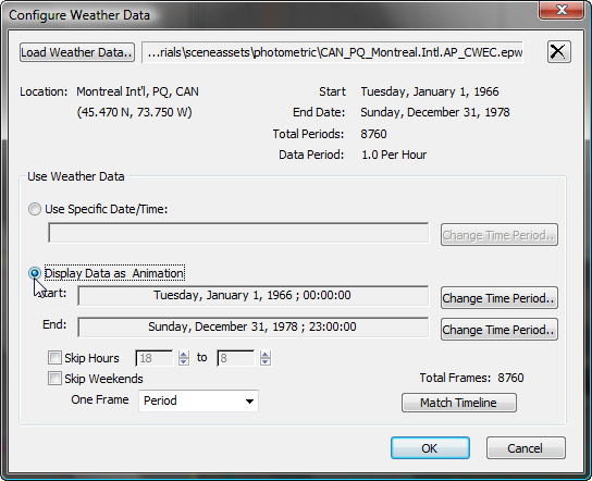

  6. In the Modify panel Daylight Parameters rollout Position group, choose Weather Data File, then click Setup.
  7. On the Configure Weather Data dialog, click Load Weather Data.
  8. On the Open Weather File dialog, choose the weather file you just saved from the Web, then click Open.

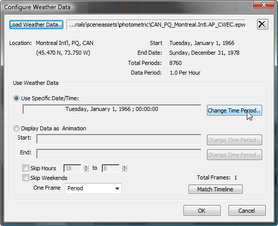

  9. In the Configure Weather Data dialog Use Weather Data group, click Change Time Period.
    By default, the weather data is set to January 1st, 1966, at noon, but you will choose a summer date.

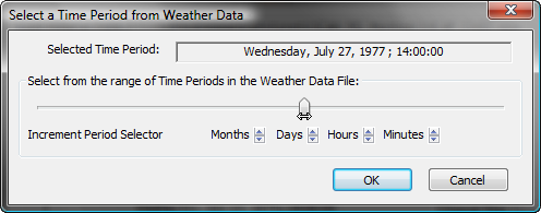

  10. On the Select A Time Period From Weather Data dialog, drag the Time Period slider until the Selected Time Period box displays Wednesday, July 27, 1977; 14:00:00.
    Use the Increment Period Selector controls to narrow down the selection if you need to. Click OK.

  11. On the Configure Weather Data dialog, click OK to add the weather data to the scene.

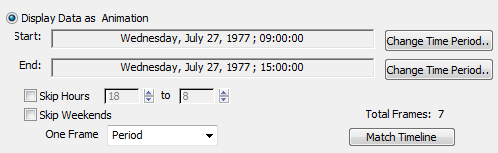

  1. With the Daylight sun object selected, go to the Modify panel and in the Daylight Parameters rollout Position group, click Setup.
  2. In the Use Weather Data group, choose Display Data As Animation.
  3. For the Start value, click Change Time Period and in the Select A Time Period From Weather Data dialog, use the slider and spinner controls to set the date and time to Wednesday, July 27, 1977; 9:00:00, then click OK.
  4. Repeat the previous step for the End value and set the time to 15:00:00.
    The Use Weather Data group indicates a total of seven frames created as a result of the selection range.
  5. Click Match Timeline, then click OK.
    The timeline updates to show seven frames.

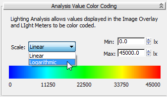

  1. From the main menu, choose Lighting Analysis Lighting Analysis Assistant, and go to the General panel.
    The Analysis Value Color Coding rollout displays a color ramp. The ramp intensity range is currently set between 0.0 and 10000.0 units. The units are in lux (lx), the international unit of measure. If you prefer, you can switch to the United States unit of measure, foot-candles (fc) on the Units Setup dialog.
    Given that the scene illumination is over 42,000 lux in places, the color range is currently too narrow. You need to widen the color ramp range.
  2. Change the value of the Max spinner to 45000.0, and press .
    In the viewport, the color range now shows light intensity much more effectively.
    Light meter readings showing improved color coded feedback
    The orange areas of the tennis court interior show direct sunlight for this time of day, while the blue areas show indirect sunlight.
  3. From the Scale drop-down list, choose Logarithmic.
    The color-coded areas update to provide a different visualization of the light intensity, but the intensity values themselves remain unchanged.
  4. From the Scale list, choose Linear again.
