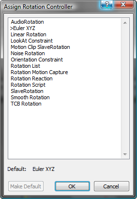

  2. Right-click the main Rotation track. From the quad menu, choose Assign Controller.
    3ds Max opens an Assign Controller dialog.
  3. In the Assign Rotation Controller dialog, click to choose TCB Rotation, then click OK.
    Now the basketball has a single Rotation track, with no subordinate X, Y, and Z Rotation tracks.

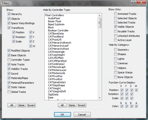

  4. On the Track View - Curve Editor toolbar, click (Filters).
    3ds Max opens the Track View Filters dialog.
    If this button is not initially visible, right-click a blank area of the Track View toolbar and choose Show Toolbars Controllers: Track View.
  5. In the Filters dialog Show group (on the left), click to turn on Controller Types, and then click OK.
    Now the controller window lists controller types.
    Tip: Although by default 3ds Max does not display controller types in the controller window, turning on their display can help you keep track of the animation you are creating.

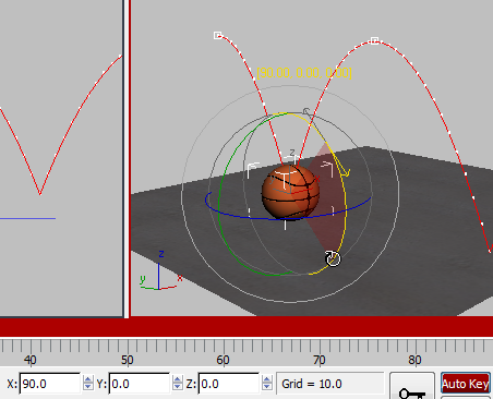

Add rotation to the basketball:
  1. Turn on .
  2. On the main toolbar, turn on (Angle Snap).
  3. Drag the time slider to frame 15. In the Perspective viewport, rotate the basketball 90 degrees forward in the X-axis. Watch the X field in the status bar to check the value.
    Forward rotation at frame 15
  4. Drag the time slider to frame 30. Rotate the basketball forward another 90 degrees along the X-axis.

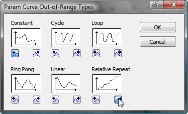

  2. On the Track View - Curve Editor toolbar, click (Parameter Curve Out-Of-Range Types).
  3. In the Param Curve Out-Of-Range Types dialog, click the outgoing button for the Releative Repeat option, then click OK.
    (As before, you can leave the incoming animation set to Constant, because the bounce begins at the start of the scene animation.)
  4. Scrub the time slider to see the animation. The texture of the basketball makes it easy to see the rolling motion.
