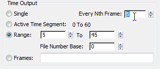

  1. On the main toolbar, click (Render Setup).
    3ds Max opens the Render Setup dialog. The Common panel is active.
  2. In the Common Parameters rollout Time Output group, set the range from frame 5 to frame 45 (0800 to 1600 hours). Also set Every Nth Frame to 5.
    You will render nine snapshot frames over the course of the main daylight hours.
