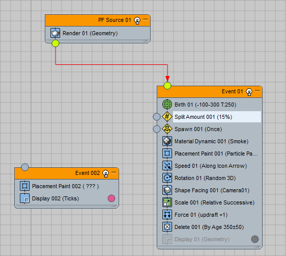

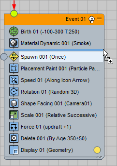

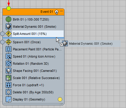

Set aside some particles to behave as embers:
- Restore Particle View (6).

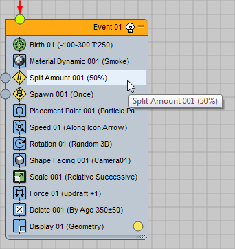

- Drag a Split Amount test from the depot, and drop it on Event 01 just above the Spawn test (and below the Material Dynamic operator).
- Click the Split Amount test to highlight it.
- On the Split Amount rollout, make sure Test True For
Fraction Of Particles is chosen, then change the value of Test True For
Ratio % to 15.0.
This “siphons off” 15 percent of the original 250 particles (because the Split Amount test precedes the Spawn test). These particles will become embers.
- Drag the Material Dynamic operator and drop it below the Spawn test.
Moving the Material Dynamic operater enables you to assign the ember particles a different material from the smoke particles.

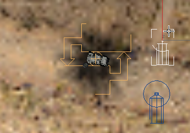

Add a new Particle Paint helper:
- In Event 01, click the icon of the Display operator to turn the Display operator off.
This disables particle display in viewpors (though not in renderings). This is a temporary measure to make it easier for you to paint new particle seeds.
Tip: If the particles remain visible in viewports, drag the time slider.
- Hide Particle View (6).

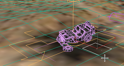

- Activate the Top viewport, and
zoom in on the jeep.
Go to frame 0.
- On the
Create panel, activate
(Helpers). Choose Particle Flow from the drop-down list, then on the Object Type rollout, click to activate Particle Paint.
- In the Top viewport, drag near the jeep to create a second Particle Paint helper.
- On the Setup rollout, change the Brush Radius value to 0.4.
Now you are ready to paint the seeds for the ember particles.

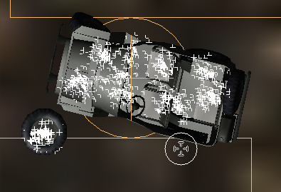

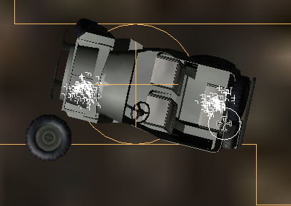

Paint where and when the embers will appear
For the smoke, you painted all seed particles at frame 0. For the embers, you will add them at particular frames, to distribute them in time as well as in space.

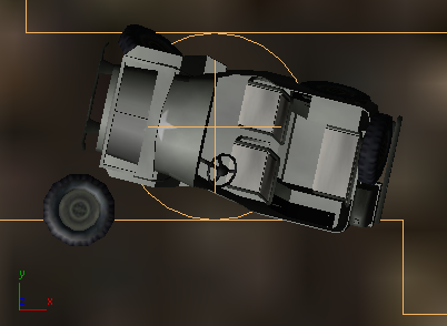

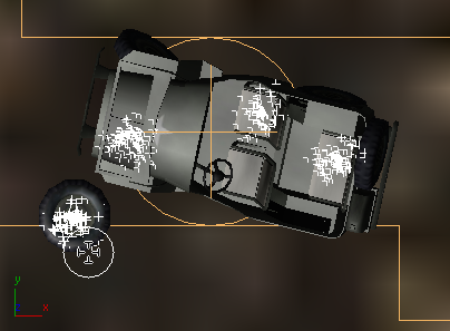

- Make sure Particle Paint 002 is still selected, then go to the
Modify panel.
zoom in even more closely, so you can see the geometry of the jeep.
- On the
Modify panel
Setup rollout, click to turn on Freehand Paint.
- At frame 0, paint two short strokes on the body of the jeep.
Tip: In Realistic and Shaded viewports, using Freehand Paint can sometimes cause the jeep object to disappear. If this happens, change the viewport to a Wireframe view.
- Drag the time slide to frame 80, and paint two more strokes.
- Add an additional two short strokes at the following frames:
- Frame 160
- Frame 240
- Frame 280
When you are done, the jeep will be fairly well covered with particle seeds.
- Right-click to turn off Freehand Paint.
- If you need to, change the viewport display back to Realistic or Shaded.
Add the embers to the particle system:

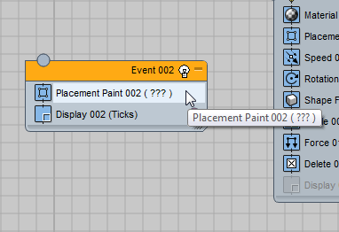

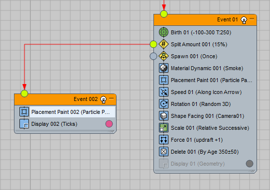

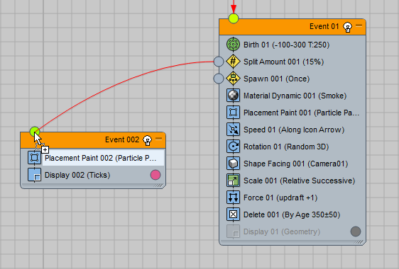

- Drag a Placement Paint operator from the depot to the gray area of the event display.
When you drop an event (an operator, test, and so on) the empty part of the event display, Particle Flow creates a new event. Initially, the new event contains the operator you dropped and a Display operator.
Tip: To rearrange events and the root PF Source entry in the event display, simply drag the entry by its title bar.
- In Event 02, click the Placement Paint operator to highlight it.
- Move Particle View so you can see a viewport that shows the Particle Paint 002 helper icon.
- On the Placement Paint rollout, click the Particle Paint Helper button (initially, it is labeled “None”).
- In a viewport, click the Particle Paint 002 helper icon.
Event 002 will use Particle Paint 002 as the source for generating ember particles.
- In the Particle Paint rollout
Acquire Paint Data group, choose Paint Position To
Position.
- In the Index Order group, turn on Stop If Count Overflow.
- In the event display, the round blue sockets that protrude from test actions are known as test outputs. Connect the Split Amount test to Event 02 by dragging a wire from the Split Amount test output to the input socket of Event 002.
Particle Flow wires the test to the new event.
Now Event 002 can use the particles that Split Amount sends to it.

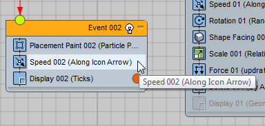

Adjust the ember particle behavior:

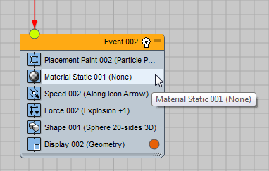

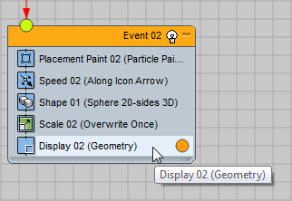

- Drag a Speed operator from the depot, and drop it on Event 02.
- Click the new Speed operator to highlight it.
- On the Speed rollout, change the value of Speed to 20.0, and the value of Variation to 10.0.
Now the particles move more slowly, and they all move vertically upward as the smoke particles initially did.
You will add space warps so the particles come back down to earth. But first, you will adjust how the particles appear in viewports and renderings.

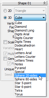

- Drag a Shape operator from the depot, and drop it on Event 002.
- Click the new Shape operator to highlight it.
- On the Shape rollout, leave 3D chosen, and choose Sphere 20-Sides from the 3D drop-down list.
- Change the Size value to 1.5.
- Click to turn on Scale %. Leave its value at the default of 100.0.
- In Event 002, click the Display operator to highlight it.
- On the Display rollout, choose Geometry from the Type drop-down list.
Now the ember particle geometry is visible in viewports.

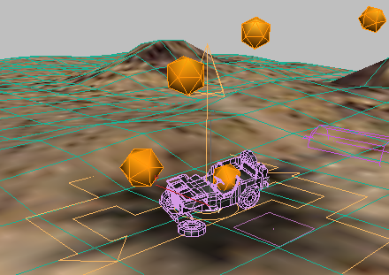

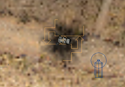

Add a Wind space warp to propel the embers:
- On the
Create panel, click to activate
(Space Warps).
- On the Object Type rollout, activate Wind.
- In the Top viewport, drag to create a Wind space warp centered on the jeep.
The new space warp is a little easier to see in the Perspective viewport.
- Name the new Wind space warp Explosion.
- In the Parameters rollout
Force group, change the wind direction to Spherical.
- Also in the Force group, change the value of Strength to 0.02.
Display group, change the Icon Size value to 0.6.
The Explosion space warp will propel the embers in circular paths.
Add a Gravity space warp so the embers will fall back to earth:
- On the Create panel
Object Type rollout, activate Gravity.
- In the Perspective viewport, drag near the jeep to create a Gravity space warp.
Display group, change the Icon Size value to 1.2.
Force group, change the Strength value to 0.04.
The force of gravity is slightly greater than the force of the wind.
Now you can use the space warps to control the ember particles.

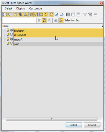

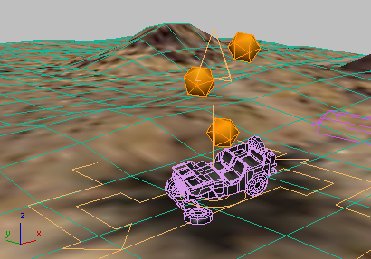

- Drag from the depot to add a Force operator to Event 02.
- Click the new Force operator to highlight it.
- On the Force rollout, click By List.
- In the Select Force Space Warps dialog, click and
+click to select the space warps Explosion and Gravity001, then click Select.
Now the combination of a (spherical) wind and gravity will control the ember particles.
- Drag the time slider or
play the animation. The embers fly out of the jeep, then fall back to the earth. They are easiest to see in the Perspective viewport. They look rather large: But as with the smoke particles, the material you apply will help fix their appearance. Creating that material is the subject of the next procedure.

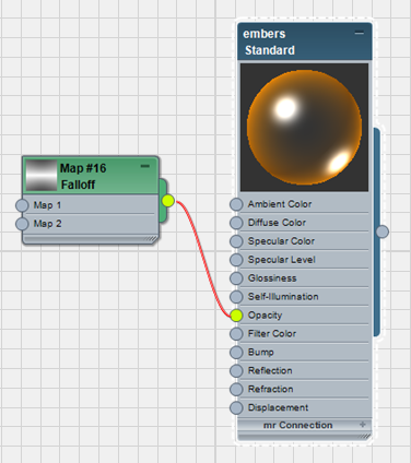

- Drag a Falloff map from the Browser to the Embers view, and wire it to the Opacity component of the Embers material.
By default, the falloff map makes the edges opaque and the center transparent: This is the opposite of the effect we want.
- Double-click the Falloff node so you can see its parameters.
- On the Falloff Parameters rollout, click
(Swap Colors/Maps). Now the center is opaque, and the edges are transparent.

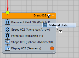

- Drag from the depot to add a Material Static operator to Event 02.
You can use a Material Static operator for the embers event, because the material doesn’t change over time.
- Click the new Material Static operator to highlight it.

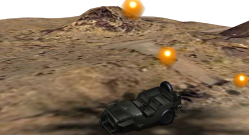

- On the Material Static rollout, click the Assign Material button (initially it is labeled, “None”).
- In the Material/Map Browser
Sample Slots group, double-click the Embers material.

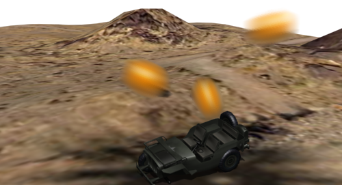

You can see the embers effect most clearly by rendering the Perspective viewport. (For this illustration, we turned off rendering for the smoke particles.)
Up close, the embers still don’t look too realistic. But they will look all right when you render the Camera01 viewport, and you will enhance the effect by adding motion blur to the embers. That is the subject of the next procedure.

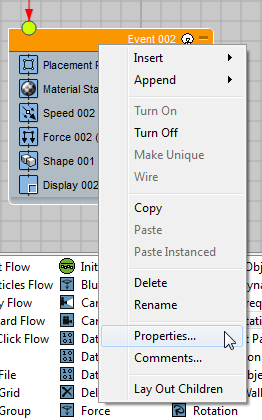

- In Particle View, click the title bar of Event 02 to select the entire event.
- Right-click, and from the pop-up menu, choose Properties.
3ds Max opens an Object Properties dialog for Event 02.
- In the General panel
Motion Blur group, make sure Enabled is turned on, then click to choose Image.
- Also in the Motion Blur group, change the Multiplier value to 10.0.
- Click OK to close the Object Properties dialog.
- Activate the Perspective viewport, drag the time slider until you have a frame with embers in it, then
render the scene.
3ds Max renders the frame, and then in a second pass, adds motion blur to the ember particles. (For this illustration, we turned off rendering for the smoke particles, once again.)
In the Camera01 viewport, the effect is subtle because the embers are at a distance. The motion blur effect is most apparent when you play the animation.

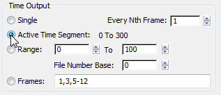

(Optional) Render the animation:
- On the main toolbar, click
(Render Setup). 3ds Max opens the Render Setup dialog.
- In the Time Output group, choose Active Time Segment.
Tip: Rendering at the full resolution of 1024 x 554 can take a lot of time. Before you render, you might want to reduce the size of frames in the movie; for example, to 500 x 271. Smaller frames render more quickly.
- Scroll down to the Render Output group, and click Files.
3ds Max opens a file dialog. Enter a name for the file, choose a movie file type (AVI or MOV), and then click Save. 3ds Max opens a compression setup dialog for the movie format you chose. Adjust the settings or accept the defaults, and then click OK.
- In Render Output group, make sure Save File is turned on. (By default, it turns on when you specify an output file.)

- The Split Amount test is one way to treat a set of particles differently from the original set.
