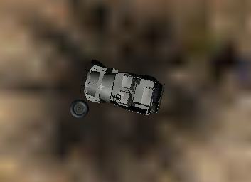

  1. In the Top viewport, zoom in on the area around the wrecked jeep.
    The jeep is in the road, toward the right-hand side of the landscape.

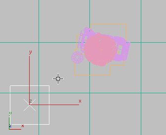

  5. In the Top viewport, drag across the jeep to create a Particle Flow source icon.
  6. Go to the Modify panel. On the Emission rollout, change the Icon Type from Rectangle to Circle.
  7. Also on the Emission rollout, set the circle Diameter to 3.0.
    Particles will be emitted from the area of the circle, which is a bit smaller than the size of the jeep itself.

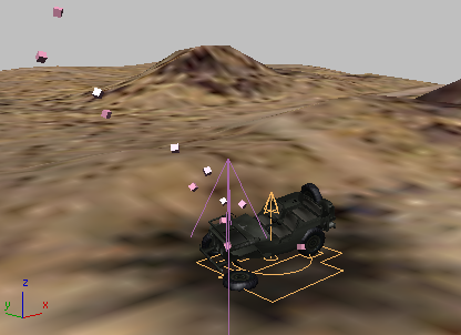

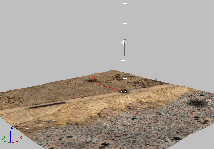

  9. If you drag the time slider, you can see in the Orthographic viewport that particles are being emitted downward. This is the default orientation when you create the icon in the Top view.

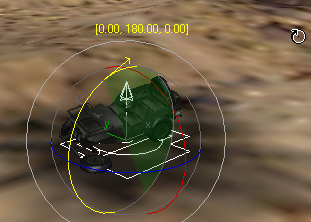

  10. Activate the Perspective viewport. Activate (Select And Rotate) and turn on (Angle Snap Toggle), then rotate the Particle Flow icon 180 degrees about its Y axis, so the arrow points straight up.
  11. Drag the time slider again.
    Now the particles move upward instead of downward, and you can see them in all four viewports.

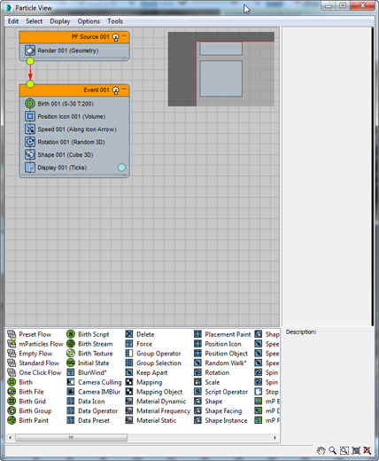

  1. Go to the Modify panel. On the Setup rollout, click Particle View.
    3ds Max opens a Particle View window.

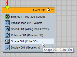

    Particle View is the main interface to Particle Flow systems. This is where you add and adjust the particle behavior. In the window, the main areas are the event display at upper left, which shows events you’ve already created, and the “depot” at lower left, which contains operators that you can add to the event display.

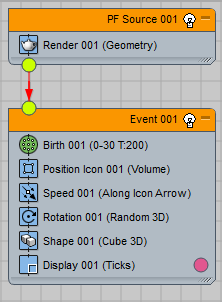

    At present, the event display shows the PF Source 01 operator you added to the scene, and Event 01, which so far contains default settings.
  2. In Event 01, click the Birth 01 operator to highlight it.
    On the right side of Particle View, 3ds Max displays a parameters rollout for the Birth operator. As the fields show, the Birth operator generates 200 particles in all. It starts emitting particles at frame 0, and stops emitting them at frame 30.
  3. Change the value of Emit Start to –100 and the value of Emit Stop to 300.
    Starting emission at an imaginary frame –100 means tells 3ds Max to generate particles before the animation begins, so there will already be some smoke in the scene at frame 0. Stopping particle emission at frame 300, the last frame of the animation, means that smoke will continue to appear throughout the animation.

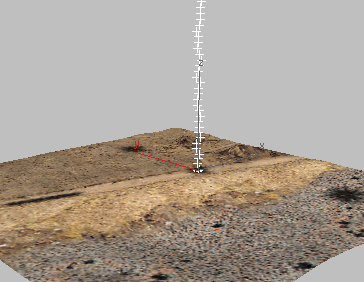

  4. Drag the time slider to see the animation.
    Particles are present at frame 0, and they continue throughout the animation, but so far, they aren’t exactly billowing.
  5. On the Birth rollout, change the value of Amount to 2000.
  6. Drag the time slider again.
    Now the particles are more numerous and beginning to look a little more like smoke, but they are still moving too quickly.

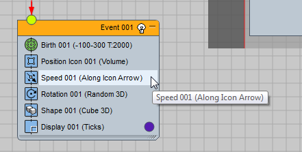

    1. In the event display, click the Speed 01 operator to highlight it.
      In the parameters panel on the right side of Particle View, 3ds Max replaces the Birth rollout with a Speed operator rollout.

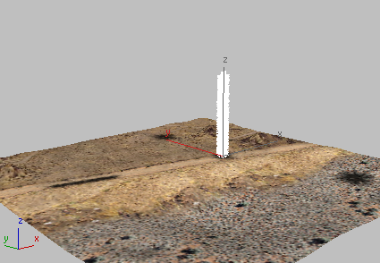

  7. On the Speed rollout, change the value of Speed to 6.0, and the value of Variation to 1.0.
  8. Drag the time slider.
    Now the smoke rises more slowly, in a dense column. This is a better effect, but its path is unnaturally straight and vertical.

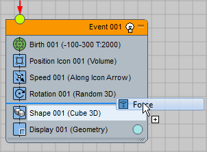

  2. In the “depot” at the lower left of Particle View, click to highlight the Force operator, then drag it to the event display, and drop it on Event 01, just above the Shape operator.
    Force operator in the depot
    Dropping the Force operator on the event

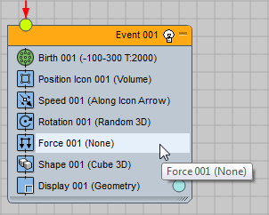

  3. Click the new Force operator entry to highlight it.
    3ds Max displays the Force operator parameters in a rollout on the parameters panel to the right.

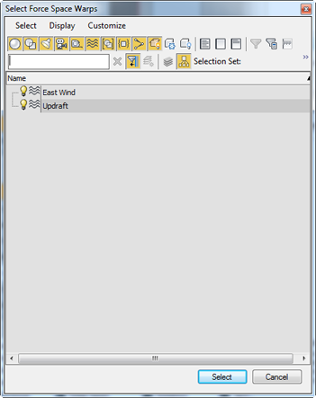

  4. On the Force 01 rollout, click By List.
    3ds Max opens a Select Force Space Warps dialog.
  5. Click and +click to highlight both the East Wind and Updraft space warps, and then click Select.

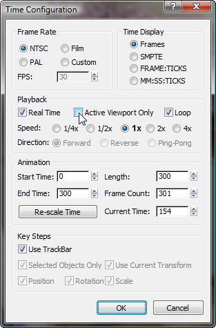

  8. Click (Time Configuration), and in the Time Configuration dialog Playback group, turn off Active Viewport only, then click OK.
  9. Play the animation.
