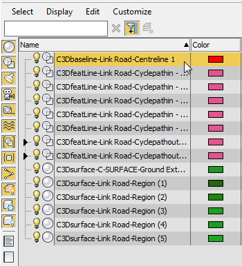

  1. On the Scene Explorer, select the centerline of the road, C3Dbaseline-Link Road-Centreline 1.

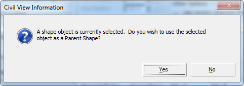

    3ds Max Design asks if you want to use the selected shape as a parent shape.
  3. Click Yes.
    The street furniture and vehicles will be placed relative to this shape, the centerline of the road.

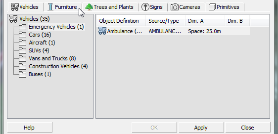

  4. On the toolbar above the list of elements, click (Add new element).
    3ds Max Design adds an element to the list. By default, this is a vehicle.

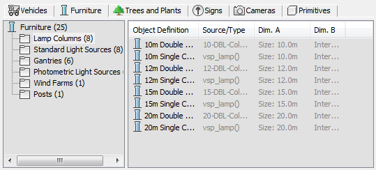

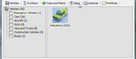

  5. On the element editor toward the bottom of the OPS Editor (the library panel), click the Furniture tab.
    The panels display lists of street furniture.

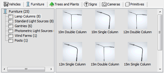

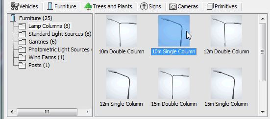

  6. Right-click the right-hand list, and from the pop-up menu choose Large Icons.
  7. Click to highlight the entry 10m Single Column.

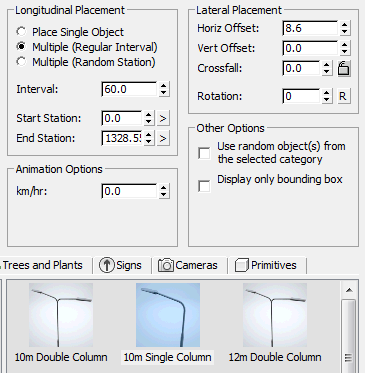

  8. In the Longitudinal Placement group, choose Multiple (Regular Interval), then in the Lateral Placement group, change the Horiz[ontal] Offset value to 8.6.
  9. Click Apply.

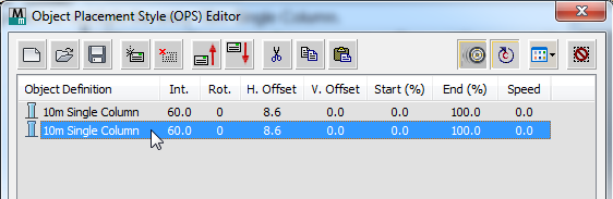

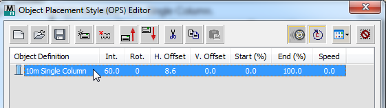

  1. In the elements list, click to highlight the 10m Single Column entry.
  2. On the toolbar, click (Copy Element), then click (Paste Element) to add a duplicate streetlight entry to the list.
  3. Click to highlight the new streetlight entry.
  4. In the Lateral Placement group, change the Horiz[ontal] Offset to –8.6 and the Rotation to 180.
  5. Click Apply.
    Now the streetlights line both sides of the road.

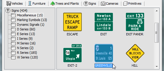

  3. On the element editor, click the Signs tab.
  4. With the Miscellaneous group highlighted in the hierarchy at the left, scroll down the list at the right and click to highlight the sign labeled GREENVILLE.
