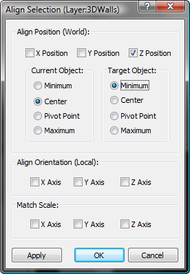

  3. In the Align Selection dialog, turn off X Position and Y Position. Turn on Z Position. For Current Object choose Center, and for Target Object choose Minimum.
    This aligns the floor with the bottom of the walls, along the floor's local Z axis.
  4. In the Align Selection dialog, click OK.
