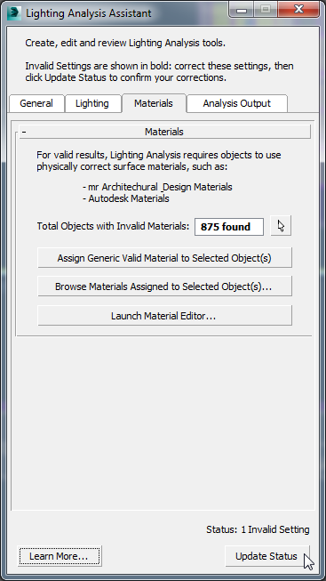

  1. From the main menu, choose Lighting Analysis Lighting Analysis Assistant.
    3ds Max opens the Lighting Analysis Assistant dialog. This is where you activate and edit the tools used to analyze lighting in a scene.
    Note: The Lighting Analysis Assistant is available in 3ds Max Design only.
    The status line at the bottom of the dialog indicates the number of invalid settings, if any, that you must correct.
    Note: The dialog might show 2 Invalid Settings, with the Daylight system lights being reported. You can ignore the message about the lights.
  2. Go to the Materials tab.

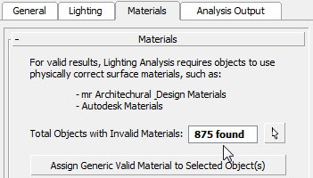

    The Lighting Analysis tool requires that all objects in the scene use physically correct surface materials. Only objects assigned the mental ray Arch & Design material or one of the Autodesk Materials (including materials from the Autodesk Material Library) are permitted. All other materials are considered invalid. Objects with no material assigned are also treated as invalid.
    The Materials rollout Total Objects With Invalid Materials box indicates the presence of 875 invalid objects in the scene, which you must now correct.

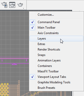

  2. Right-click an empty gray area of the main toolbar and choose Layers.

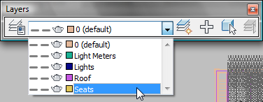

    3ds Max opens the Layers toolbar. A layer called Seats has already been created for you.
  3. Open the layer list and choose Seats from the list.
  4. On the Layers toolbar, click (Select Objects In Current Layer).
    All seat objects are selected. On the Modify panel, you can see that 874 objects are selected: This is just one object short of the 875 total number of objects with invalid materials.

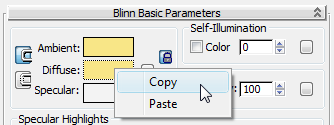

  4. On the Blinn Basic Parameters rollout, right-click the Diffuse color swatch and choose Copy.
    This saves the color for use in the new material you will now apply to the seats.

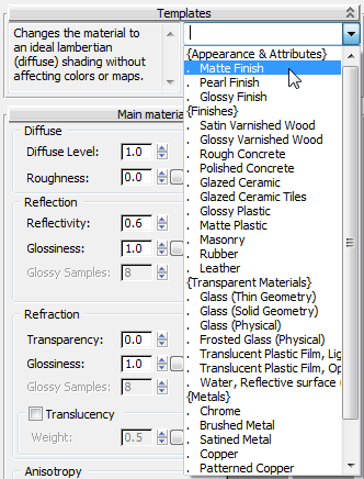

  8. On the Templates rollout, choose Matte Finish from the list.
    This gives the material a neutral reflectivity.

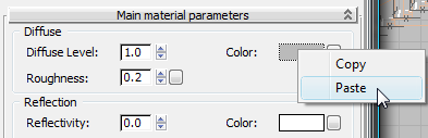

  9. In the Main Material Parameters rollout Diffuse group, right-click the Color swatch and choose Paste.
    This copies the color from the Standard material to the Arch & Design material.

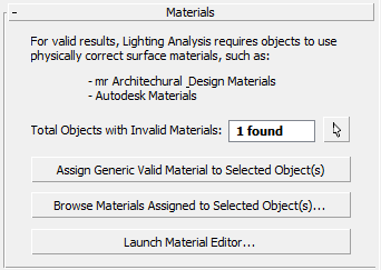

  1. On the Lighting Analysis Assistant dialog, click Update Status.
    On the Materials rollout, the Total Objects With Invalid Materials field updates to show only one remaining object with an invalid material.

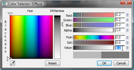

  7. In the Main Material Parameters rollout Diffuse group, click the Color swatch.
  8. On the Color Selector, change the HSV Value to 0.2.
    This gives the material low reflectivity.

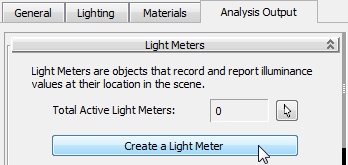

  4. On the Lighting Analysis Assistant dialog, go to the Analysis Output panel and on the Light Meters rollout, click Create A Light Meter.
