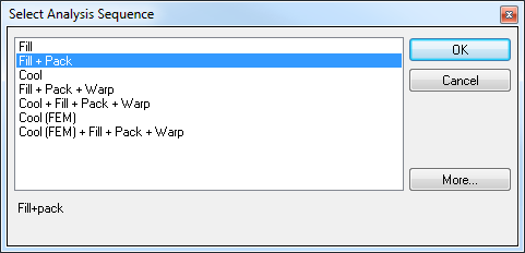

Set the Analysis Sequence
To predict the orientations of a fiber-filled material, we must use a Fill + Pack analysis sequence.
Click
Home
Molding Process Setup
Analysis Sequence
Click
Fill + Pack
Click
OK
