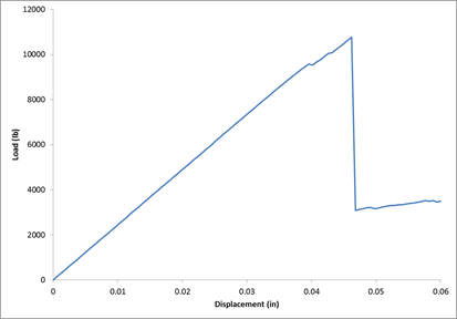

Load-displacement plots are commonly used as tools to determine the global stiffness response of a structure. They are particularly useful for progressive failure analyses as they are a simple means of determining how the structure behaves as failure initiates and progresses. To generate a load-displacement plot, data must be extracted from the output file.

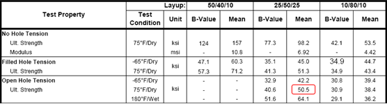

The plot of the load-displacement curve is given in below. The sharp drop in stiffness at a displacement of 0.0462 corresponds to ultimate failure of the plate. The simulated ultimate load is 10,769 lbs and the strength is 49.9 ksi. The experimental [1] strength of the plate is given in the table below as 50.5 ksi. The ultimate strength predicted by Simulation Composite Analysis and the experimental strength differ by just 1.2%.
