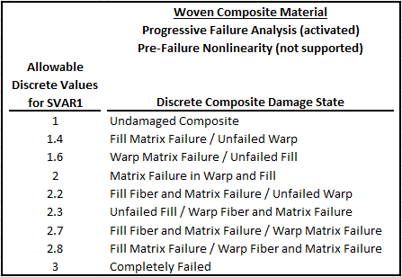

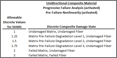

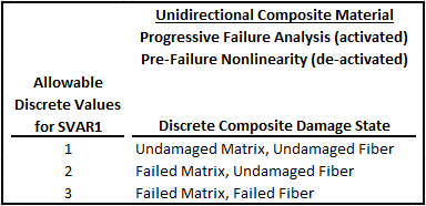

SVAR1 is an integer variable that represents the discrete damage state of the composite material. The range and interpretation of integer values assumed by SVAR1 depend upon the specific set of material nonlinearity features used in the analysis. The following tables provide the interpretation for each allowable integer value of SVAR1 for each possible combination of material nonlinearity features employed by Simulation Composite Analysis.
Unidirectional Composites - Static Analyses
For unidirectional composite materials, state variables SVAR2, SVAR3, ..., SVAR35 have the following interpretations for static progressive failure analyses:
- SVAR2
- SVAR2 is a continuous real variable ranging from 0.0 to 1.0, indicating the fraction of the matrix failure criterion that has been satisfied. For example, SVAR2 = 0.0 implies that the matrix stress level is zero, while SVAR2 = 1.0 implies that the matrix stress has reached failure level. Numerically, SVAR2 is computed as
which is recognized as the left hand side of the matrix failure criterion (see the MCT Constituent-Based Failure Criteria section of the Theory Manual).
- SVAR3
- SVAR3 is a continuous real variable ranging from 0.0 to 1.0, indicating the fraction of the fiber failure criterion that has been satisfied. For example, SVAR3 = 0.0 implies that the fiber stress level is zero, while SVAR3 = 1.0 implies that the fiber stress has reached failure level. Numerically, SVAR3 is computed as
which is recognized as the left hand side of the fiber failure criterion (see the MCT Constituent-Based Failure Criteria section of the Theory Manual).
- SVAR4
- SVAR4 indicates whether the axial strain in the fiber constituent is positive or negative when fiber failure occurrs. If the axial strain is positive, SVAR4 = 1.0. If the axial strain is negative, SVAR4 = -1.0
- SVAR5
- SVAR5 is the fourth term in the matrix failure criterion and is used in the pre-failure nonlinearity feature (see the Theory Manual).
- SVAR6 - SVAR11
- Unused
For the case of unidirectional composites, the remaining MCT state variables store the individual components of the matrix average stress and strain states and the fiber average stress and strain states.

Woven Composites - Static Analyses
For woven composite materials, state variables SVAR2, SVAR3, ..., SVAR90 have the following interpretations for static progressive failure analyses:
- SVAR2
- SVAR2 is a continuous real variable ranging from 0.0 to 1.0, indicating the fraction of the matrix failure criterion that has been satisfied for the matrix constituent within the fill tows.
- SVAR3
- SVAR3 is a continuous real variable ranging from 0.0 to 1.0, indicating the fraction of the fiber failure criterion that has been satisfied for the fiber constituent within the fill tows.
- SVAR4
- SVAR4 is a continuous real variable ranging from 0.0 to 1.0, indicating the fraction of the matrix failure criterion that has been satisfied for the matrix constituent within the warp tows.
- SVAR5
- SVAR5 is a continuous real variable ranging from 0.0 to 1.0, indicating the fraction of the fiber failure criterion that has been satisfied for the fiber constituent within the warp tows.
- SVAR6
- Unused

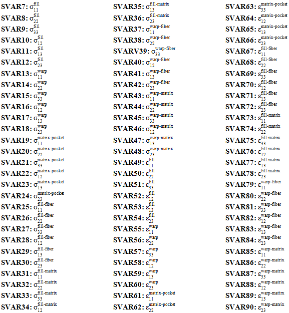

For the case of woven composites, the remaining MCT state variables store the individual components of the average stress and strain states in the various superconstituents and constituents (e.g., fill = fill tow superconstituent, warp = warp tow superconstituent, matrix-pocket = matrix constituent of the intertow matrix pockets, fill-matrix = the matrix constituent of the fill tow, warp-matrix = the matrix constituent of the warp tow, fill-fiber = the fiber constituent of the fill tow, warp-fiber = the fiber constituent of the warp tow).

For the case of a progressive fatigue analysis with woven materials, SVAR11 through SVAR94 are used to store the individual components of the average stress and strain states in the various superconstituents and constituents (equivalent to SVAR7 through SVAR90 for static analyses).
