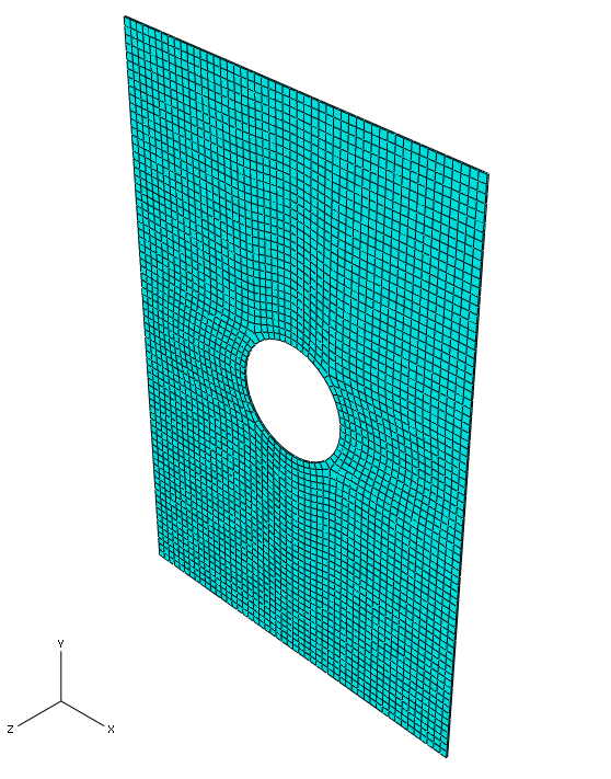

In meshing the composite plate, an approximate seed size of 0.2 is used to ensure that the mesh is fine enough to capture the location of failure, but also coarse enough for a short solution time.

  7. Mesh the part by clicking the Mesh Part icon or by selecting Mesh > Part from the main toolbar. Click the Yes button. The mesh should be similar to the mesh shown below.
