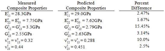

If the micro-mechanical finite element model is used in conjunction with the measured bulk constituent properties, the following composite properties are predicted:

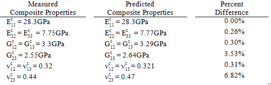

Using optimized in situ constituent properties with the micro-mechanical finite element model yields the following predicted composite properties.
Generally speaking, the use of optimized in situ constituent properties (as opposed to measured bulk constituent properties) causes the micro-mechanical finite element model to predict homogenized composite properties that agree much more closely with the actual measured composite properties. Of the six measured composite properties (,
and
are the only properties that exhibit less agreement with the measured values after completing the optimization process. This increased discrepancy between the measured and predicted values of
and
is simply caused by assigning them weight coefficients of zero. This prevents these two properties from participating in the optimization process. The reason for this choice was that the measured values of
and
for this particular composite material were considered to be significantly less accurate than the other composite properties (hence the reason for a weighted optimization).
