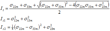

Because the matrix failure criterion used for woven composites shown below only has three coefficients, only three strength values are required. The knee strengths corresponding to the ultimate strengths +, -, and are used to directly calculate these coefficients.
where,
