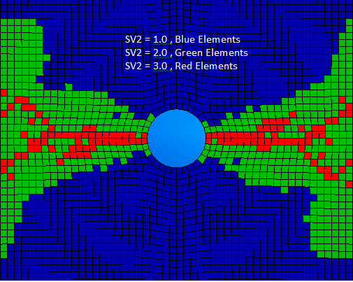

The following table lists three possible values for SV2 and the corresponding failure states. It can be helpful to decrease the spectrum to just 3 colors and specify a user-defined range so the element colors remain consistent. For example, if there are 15 colors in the spectrum and only matrix failure, Patran will automatically adjust the limits to range from 1 to 2 and red elements will correspond to matrix failure but when fiber failure occurs, the range will be adjusted to 1-3 so that red elements correspond to fiber failure instead of matrix failure. By modifying the spectrum and the range of values, SV2 will be always be from 1 to 3.

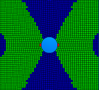

The default ply for the contour plot shown above is Ply 24. To view failure in all of the plies, envelope plots can be used. Envelope plots display the maximum or minimum integration point value across all section points in each element.
  1. To create an envelope plot, click the Layer button on the Results form and highlight all 24 layers.
  2. Select Maximum from the menu and click OK. Click Apply on the Results form.

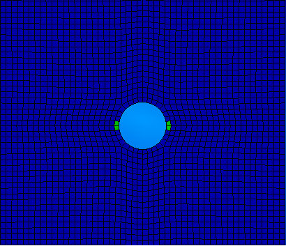

    • First matrix failure should occur at time = 0.26 (first image below)

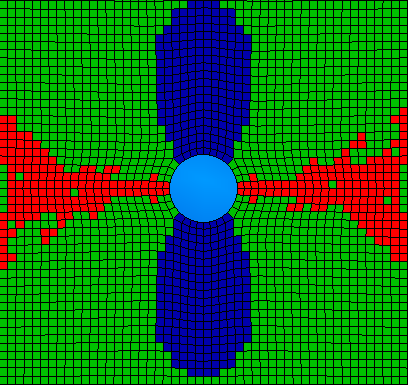

    • First fiber failure should occur at time = 0.65 (second image below)

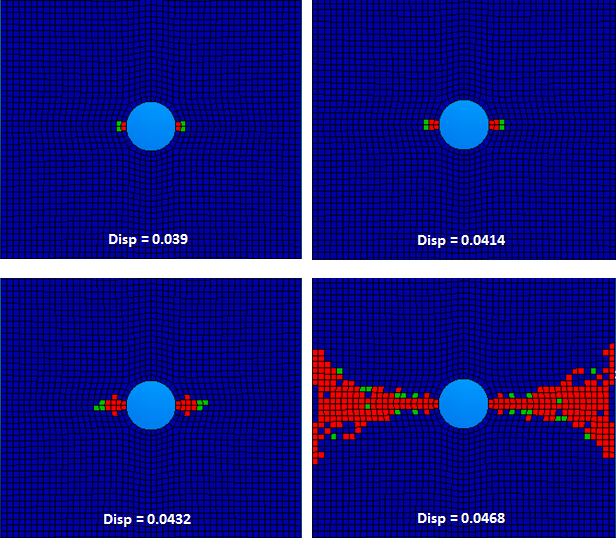

Next, consider the progression of failure in Ply 2, which is one of the main load carrying (0°) plies. The plot below shows failure in Ply 2 at several displacements. As expected, failure initiates at the edges of the notch and progresses laterally towards the edge of the plate until ultimate failure occurs.
