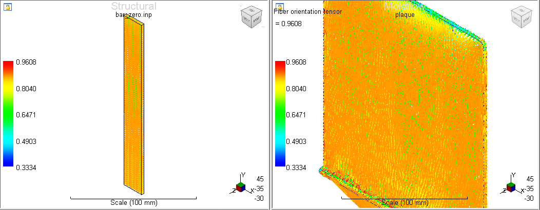

Map Results
Now we are ready to map the fiber orientations to the structural model.
  1. Click Home > Mapping > Map Results.
  2. Rotate the model as necessary to examine the fiber orientations mapped to the structural model. Switch to Fiber Orientation view if necessary (Home > View Results > Fiber Orientation).
