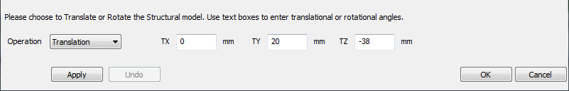

Click
Yes
when prompted to use the interactive alignment tool.
Enter
20
mm for
TY
and
-38
mm for
TZ
and click
Apply

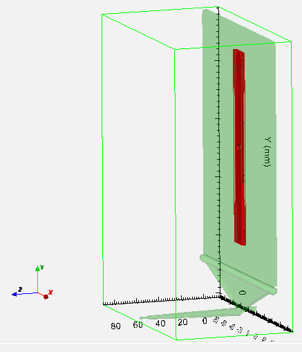

Use your mouse to rotate the model and make sure the two parts are aligned properly. Click
OK
