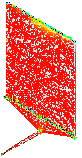

Fiber orientation tensor
in the study tasks list.
Rotate the model as necessary to see the predicted orientations for our glass fiber reinforced material.
