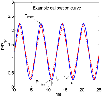

The iterative step of the material fatigue characterization involves adjusting Ub,, Uh, and ψ to minimize the error between the log of the cycles to failure and the log of the predicted number of cycles to failure. Accomplishing this task requires an assumption about the load history. We assume the load history has a saw-toothed shape, as shown by the red curve below. As with the static in situ properties, the gradient method of steepest descent is used to optimize the fatigue parameters.
