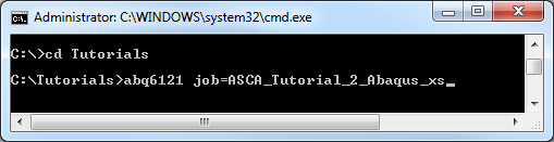

  1. Open a command prompt.
  2. Change the directory to the directory where the input file is located:
    >>cd <directory containing input file>
  3. Submit the job as shown in below:
    >>abq6121 job=ASCA_Tutorial_2_Abaqus_xs
