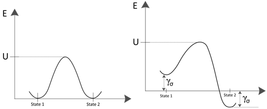

For the purposes of fracture and fatigue, one equilibrium state is the unbroken state and the other is the broken state. The process is illustrated schematically in the left image below. Thus, a similar equation can be written for bond healing as
Now consider the effect of an applied stress on the bond breaking rate described in Equation (38) and the bond healing rate described in Equation (39). In this context it is more helpful to think of stress in terms of energy per unit volume rather than force per unit area. Thus, if the stress is acting to facilitate the bond-breaking process it should reduce the energy barrier to bond-breaking and increase the energy barrier required for bond healing.
The difference depends on the volume of material , the activation volume over which the process occurs 1 so that the reduction in the activation energy is simply the product of activation volume and the stress. The image below on the right shows how the stress modifies the activation energy. Modifying Equation (38) to reflect the effect of an applied stress gives
Similarly for Eq. 39
