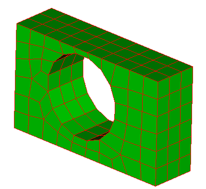

The imported model appears in a new dialog window inside the Advanced Material Exchange GUI that displays the meshed geometry.
