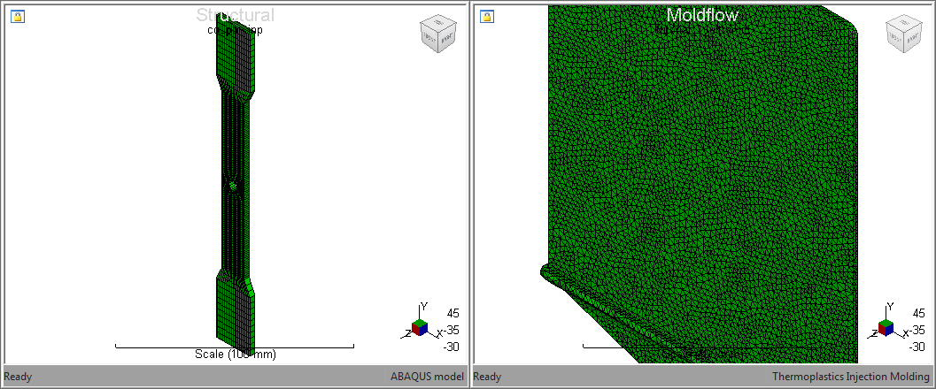

Introduction
In the following tutorial we will examine a coupon specimen, machined from an injection-molded plaque. The plaque is made from Ultramid B3EG6, a 30% glass fiber filled material. We will map the fiber orientations from the plaque to the test coupon and perform our structural analysis.
