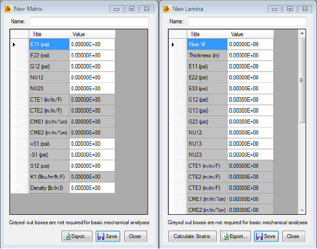

Upon selecting the New Fiber, New Matrix, New Core, or New Lamina option from the New Item drop-down menu, Simulation Composite Design brings up a new material window that is appropriate for the type of new material selected. In either case, you must:
- Specify the name for the new material.
- Specify the in-plane properties and a density of the new material.
- Save the new material in the material database.
- New Fiber, New Matrix, or New Core
- The left image below shows the New Matrix window which is similar to the New Fiber window and New Core window. These windows differ only in the specific properties available for user specification.
- New Lamina
- The right image below shows the New Lamina window. Unidirectional lamina are assumed to be transversely isotropic, with the properties in the '2' direction being equal to the properties in the '3' direction. The Calculate Strains button located on the window allows you to calculate ultimate lamina strains corresponding to the ultimate strengths of the lamina.
Material Properties
The following list briefly describes the material properties that can be entered into Simulation Composite Design. White fields (as shown above) indicate the minimum properties required; greyed-out boxes are not required for basic mechanical analyses.
