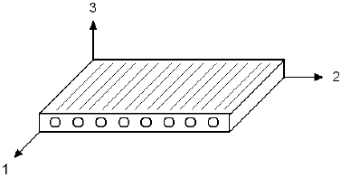

- Micromechanics is the theory by which lamina mechanical properties are calculated based upon the lamina's fiber, matrix, and fiber volume fraction. The principal material coordinate system for the lamina is shown below. The fibers are assumed to be continuous and oriented parallel with the '1' direction. The fibers are primarily responsible for the high strength and stiffness of the lamina in the '1' direction. The matrix material (or resin) provides inter-fiber elastic support, thus giving stability to the collection of reinforcing fibers. The matrix is primarily responsible for providing the lamina's stiffness and strength in the '2' and '3' directions (perpendicular to the fibers), as well as the shear stiffness and strength of the lamina in the three principal planes.

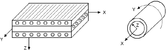

Laminate Coordinate System (left) and Cylindrical Laminate Tube Coordinate System (right)
