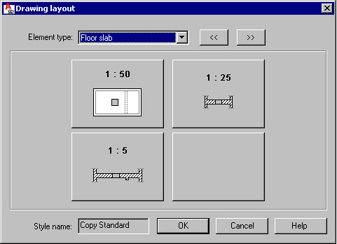

Using this dialog, you can specify which drawings will be generated (and in what scale) for selected types of structure elements.
To display the Drawing layout dialog:
For Style name, enter a name for the component style, and click Save (this is only available when creating a style, not when modifying an existing style).
For individual types of structure elements, the software creates drawings in the presented layout and defined scale:

If an empty icon displays for a selected drawing layout and a selected structure element type, the field does not contain a drawing.
Clicking an icon that symbolizes a generated drawing will display the Drawing components.
