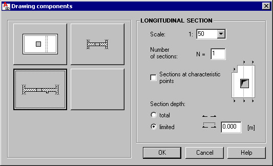

Using this dialog, you can specify which drawings will be generated (and in what scale) for selected types of structure elements.
To open the Drawing components dialog, click the icon that denotes a generated drawing in the Drawing layout dialog.
The contents of this dialog depend on the type of structure element for which it has been opened:
| Beam |
Generation of the following drawings is possible: Parameters: View scale
Parameters: View scale Number of sections in a beam Section depth: - total (section through the whole beam) - limited to a specified value If you select Sections at characteristic points, the software creates drawings in sections through the beam that are associated with additional points (such as openings or adjoining beams). |
| Column |
Parameters: View scale Number of sections in a column Section depth: - total (section through the whole column) - limited to a specified value If you select Lower column section and Upper column section, the software creates drawings of a section through the column positioned above or below a given column. Sections through a column may display in a row (next to each other horizontally) or in a column (next to each other vertically). |
Spread footing |
Parameters: View scale Section depth: - total (section through the whole spread footing) - limited to a specified value |
Wall |
Parameters: View scale Number of sections in a wall Section depth: - total (section through the whole wall) - limited to a specified value If you select Sections at characteristic points, the software creates drawings in sections through the wall that are associated with additional points (such as openings or adjoining beams). |
Continuous footing |
Parameters: View scale Section depth: - total (section through the whole continuous footing) - limited to a specified value Parameters: View scale |
Floor slab |
Parameters: View scale Number of sections in a slab Section depth: - total (section through the whole slab) - limited to a specified value If you select Sections at characteristic points, the software creates drawings in sections through the slab that are associated with additional points (such as openings or points on a broken-line-shaped edge of a slab). |
Ground beam |
Parameters: View scale Number of sections in a ground beam Section depth: - total (section through the whole ground beam) - limited to a specified value If you select Sections at characteristic points, the software creates drawings in sections throughthe ground beam that are associated with additional points (such as change of the beam section). |
Raft foundation |
Parameters: View scale Parameters: View scale Number of sections in a raft foundation Section depth: - total (section through the whole raft foundation) - limited to a specified value If you select Sections at characteristic points, the software creates drawings in sections through the raft foundation that are associated with additional points (such as points on a broken-line-shaped edge of a slab). |
Stairs |
Parameters: View scale Number of sections of stairs Section depth: - total (section through the whole stairs) - limited to a specified value |
Ring beam |
Parameters: View scale Section depth: - total (section through the whole ring beam) - limited to a specified value. |
Lintel |
Parameters: View scale Number of sections in a lintel Section depth: - total (section through the whole lintel) - limited to a specified value |
Group |
Generation of the following drawings is possible: Parameters: View scale Parameters: View scale Parameters: View scale
Parameters: View scale Number of sections in the group Section depth: - total (section through the whole group) - limited to a specified value Moreover, you can select the Sections at characteristic points option to create drawings in sections through the group that are associated with additional points (change of the beam section, and so on).
Parameters: View scale Number of sections in the group Section depth: - total (section through the whole group) - limited to a specified value Moreover, you can select the Sections at characteristic points option to create drawings in sections through the group that are associated with additional points (change of the beam section, and so on). |
If an empty icon displays for a selected drawing layout and a selected structure element type, the field does not contain a drawing.
