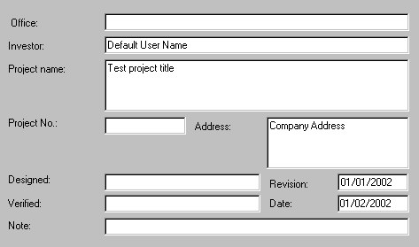

After you click Project Info from the left pane of the Project preferences dialog, the parameter options are as shown.
Use the edit fields to enter general information about the project. These fields correspond to the variables used in cells of tables included in drawings and in printout headers:
Office - VAR_OFFICE
Investor - VAR_INVESTOR
Project name - VAR_PROJ_NAME
Project No. - VAR_PROJ_NUM
Address - VAR_ADDRESS
Designed - VAR_DESIGNER
Verified - VAR_VERIF
Revision - VAR_REV
Date - VAR_DATE
Additional variables:
Scale - VAR_SCALE
Page No. - VAR_PAGENO
