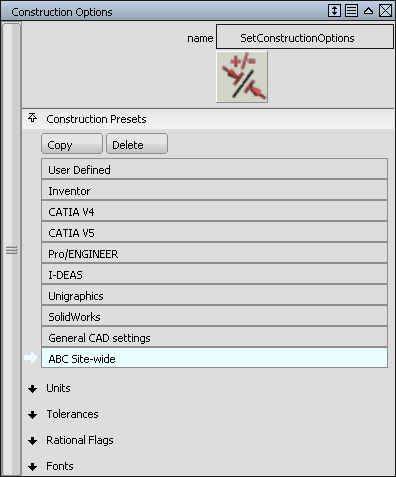

Alternatively, you can copy the file to a shared network location so that all users can access the same construction presets. (See Access site-wide construction presets on a network.)
The first line of the ConstructionPresets file specifies the default presets to use when Alias starts up. If you don’t want every user to start up with the same construction options, delete this first line.
The new construction setting is now the default and cannot be edited.

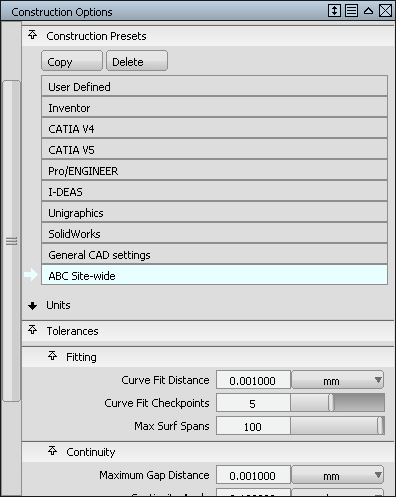

If your administrator has placed the construction presets file in a shared network location (see Set up site-wide construction presets), follow these steps to access it:
The construction option settings default to those in the construction presets file on the network. These construction presets cannot be edited.
If the environment variable is not set, Alias looks for the site-wide construction presets file in the usual location on the user's own installation.
If the administrator changes the construction presets file on the network, each user must re-launch Alias to see the changes in the Check Model and Construction Options windows.
