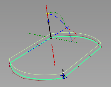

  6. Do any of the following:
    • Change the pull direction by choosing a different draft vector option or by using the pull direction manipulator (see Set the pull direction with the manipulator ).
    • Change the Draft Angle and Length of the surface(s) through the control window or by using the manipulator (see Set the angle or length at a point along the surface).
    • Turn on Explicit Control to adjust the control point layout and spans in the U direction.
    • Turn on Double Sided to make the surface(s) extend on both sides of the curves.
    • Turn on Intersect Flanges to automatically extend and/or trim the draft surface(s) at corners (where the original curves share endpoints).
    • Turn on Modify Range and use the Start/End sliders or arrow manipulators to change the extent of the draft surfaces.
  7. Click Update again to update the surface(s), or turn on Auto Update.

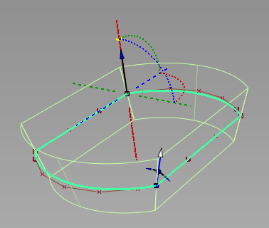

    Double-sided draft surfaces with height = 30 and draft angle = 15.

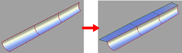

Create Flange surfaces from curves of an existing surface
Create one or more surfaces from a set of surface curves, either along a pull direction, or at an angle relative to the original surfaces.

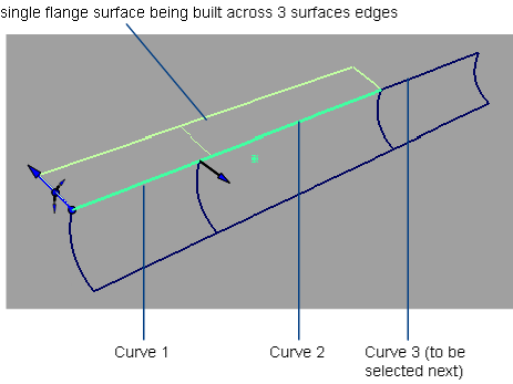

  3. Click or box-select all your curves. The curves can be disjoint (non-touching), or continuous.
    As each curve is added, it is highlighted, and a flange surface is built. A single flange surface is created no matter how many surface curves you have selected.

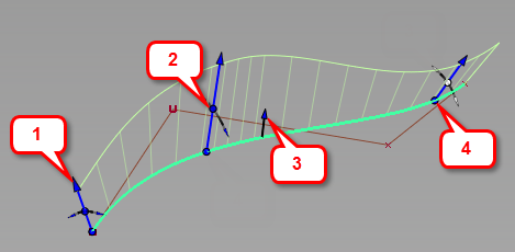

Use the Multi-Surface Draft tool manipulators to change the Length and Angle, and to reverse the direction of the new surface(s).
1 Drag the arrow head to change the length of the surface.
2 Drag the dot at the middle of the manipulator to change the Angle/Draft Angle of the surface.
3 Click the Flip arrow head to reverse the surface direction.
4 -click the input curve to add manipulators. Move a manipulator along the curve by dragging the dot at the base of the manipulator. Remove manipulators by-clicking them.

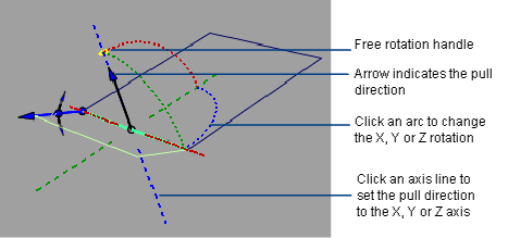

  • Click an axis line to set the pull direction.
  • Click the pull direction arrow to reverse its direction.
  • Click one of the arcs, then drag the mouse left and right to change the pull direction.
  • Click the free rotation handle to rotate freely in all directions.
  • Click an existing reference vector to align the manipulator with it.
