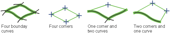

What combination of curves and corners can I use?
Note:
If you mix curves and corners, you must click the curves first.

- Click the remaining curves and/or points (corners) in clockwise or counter-clockwise order.
- You can select either four curves, four corners, one corner and two curves, or two corners and one curve.
- If you select both curves and corners, you must select the curves first.
- You can only use a snapping mode to select the first corner.

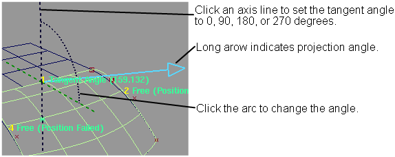

Use the tangent angle manipulator
This manipulator appears when you set an edge to Tangent Angle in the Square Control window (see below).
- Click an axis line to set the tangent angle to 0, 90, 180, or 270 degrees.
- Click an arc, then drag the mouse left and right to change the angle value, or type a number to set the value exactly.
- When you are finished, click the Go button.
