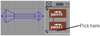

Spline IK is another alternative for creating flowing motion along a path.
The following example describes how to animate a snake slithering along a path.
Pick a curve to be used as a motion path
A series of messages appear on the prompt line, informing you of the animation’s progress.
If you don’t like the generated animation, you can delete the clusters that were created to animate the snake (ensure that the clusters are the only active geometry and then choose Delete > Delete Active
.) Since all the flow animation was on the clusters, the snake will no longer be animated and you can start again. You may want to try increasing the Flow Slices and/or the Maximum Bank values to increase the amount of banking.

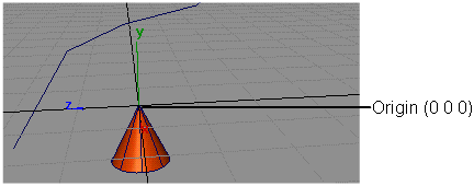

If you are not using the Flow option, then the point on the object that makes contact with the motion path curve during animation is the point that touches the origin (0,0,0) when there is no translation on the DAG node to be animated by a motion path.

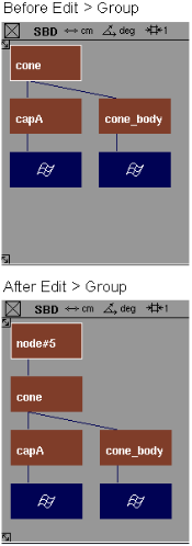

To change the point on the object that will travel along the curve, position the object so that this point touches the origin, group the object using Edit > Group
, then use Animation > Tools > Set Motion
on the grouped DAG node.

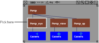

Camera Up creates X, Y, and Z translation animation for the Up DAG node of a camera. To create the animation on the Up DAG node of the camera, pick the DAG node above the Eye of the camera. If any translation animation already exists for the Up nodes, that animation is deleted.
Alternately, you could choose View > Local Move Camera > Twist
to position the up point. It is easier to position the up point of the camera if you display the camera using WindowDisplay > Toggles > Cameras
Before choosing Set motion, pick the Up DAG node for the camera you want to affect and move the Up point to the world space position that describes the sense of up for the eye point. Then choose Set motion. A NURBS curve is created that will be assigned as a motion path for the Up DAG node of the camera.
