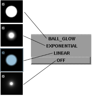

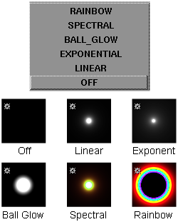

The type of glow that the light produces when viewed directly. A light without glow can illuminate objects when the scene is rendered; however, a light needs glow to be seen by the camera when the scene is rendered. You can assign glow to all types of light except ambient lights.
If Glow is set for a light, the Glow, Radial Glow Effects, and 2D Glow Noise Glow Effects parameters become available. The default setting is OFF.
| OFF | No glow |
| LINEAR | Glow slowly diminishes from the center of the light |
| EXPONENTIAL | Glow quickly diminishes from the center of the light |
| BALL_GLOW | Glow diminishes faster towards a distance (from the light center) specified by the glow Spread value |
| SPECTRAL | Lower wavelengths (red) refract (or spread) more than the higher frequencies (blue) |
| RAINBOW | Simulates refraction due to water droplets in air. The glow Spread value determines the radius of the rainbow. |

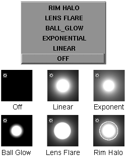

The type of halo that the light produces when viewed directly. Halo is like Glow, except that the falloff is more gradual and different falloff types are available.
The Glow Intensity value must be greater than zero for the Halo setting to have any affect. The default setting is OFF.
| OFF | No halo |
| LINEAR | Halo slowly diminishes from the center of the light |
| EXPONENTIAL | Halo quickly diminishes from the center of the light |
| BALL_GLOW | Halo diminishes faster towards a distance (from the light center) specified by the halo Spread value |
| LENS FLARE | Simulates a bright light source illuminating the surfaces of several camera lenses. The intensity of the flare is determined by the halo Intensity value. The size of the flare circles is relative to the field of view of the camera. |
| RIM HALO | Forms a circular ring with a soft central glow. The size of the ring is determined by the halo Spread value. |

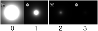

Controls how quickly light intensity decreases with distance. The Decay setting has no effect at distances less than 1 unit.
The Decay parameter works differently for volume lights (see Decay). Valid settings are 0, 1, 2 or 3. The default setting is 1.
| 0 | no decay; light reaches everything |
| 1 | light intensity decreases directly (linearly) with distance (slower than real world light) |
| 2 | light intensity decreases proportionally with the square of distance (the same as real world light) |
| 3 | light intensity decreases proportionally with the cube of distance (faster than real world light) |

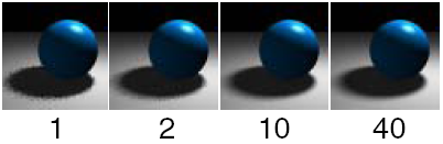

The minimum number of shadow feeler rays per sample (used to create raytracer soft shadows). A large Shadow Samples value increases rendering times but produces smoother soft shadows. The valid range is 0 to 100. The slider range is 1 to 40. The default value is 2.

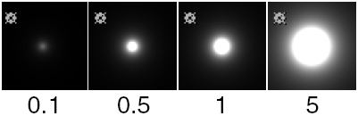

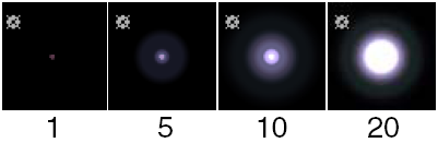

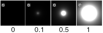

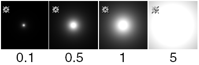

The brightness of the glow. As the Intensity value increases, so does the apparent size of the glow effect. A negative Intensity value subtracts from other glows. (The Decay value controls how the glow brightness decreases with distance.) The slider range is 0 to 5. The default value is 1.

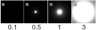

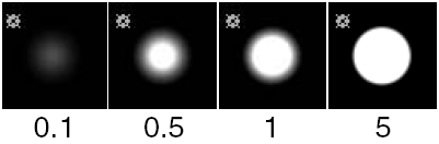

Controls the size of the glow effect. Negative values can have odd but useful effects. The slider range is 0 to 5. The default value is 1.

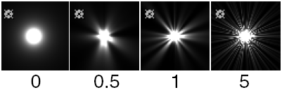

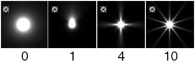

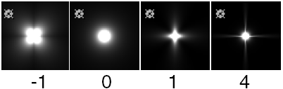

Simulates camera star filter effects. The slider range is 0 to 4. The default value is 0.
Use the Star Points parameter to set the number of points on the star. Use the Rotation parameter to rotate the star.

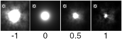

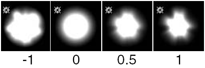

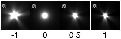

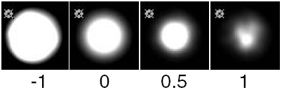

Randomizes the spread of the glow to simulate starburst effects and eyelashes refracting light. The slider range is 0 to 1. The default value is 0.
Negative values of Radial Noise produce thicker noise. Use the Noise Freq. parameter (under Radial Glow Effects) to control the smoothness of this effect.

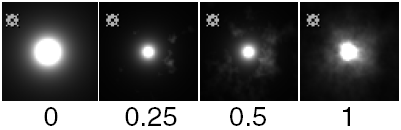

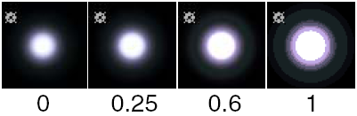

The strength of two-dimensional noise applied to the glow. The noise is generated on a plane that is centered at the location of the light and always oriented towards the camera. The slider range is 0 to 1. The default value is 0.
To create the illusion of illuminated smoke around a glowing light source, set the 2D Noise value to about 0.5 and slowly animate the Uoffset and Voffset values. The smoke will appear to slowly drift by the light.
Generally fog illumination (2D Noise under Fog Illumination) is better than glow for creating smoke and fire effects, because fog is a 3D effect (for example, glow 2D noise cannot be occluded by objects).

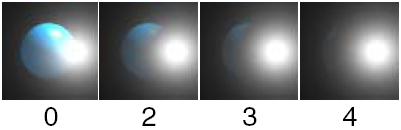

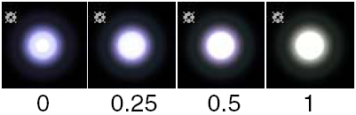

The amount that the light’s glow obscures objects behind it. Opacity can be thought of as the opposite of transparency. The slider range is 0 to 0.5. The default value is 0.

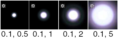

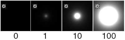

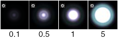

The brightness of the halo. As the Intensity value increases, so does the apparent size of the halo effect. (The Decay value controls how halo brightness decreases with distance.) The slider range is 0 to 5. The default value is 1.
Controls the size of the halo effect. The Spread value also controls the size of the glow if Glow is RIM HALO. Halo size is generally larger than glow size when the halo Spread and glow Spread values are the same. The slider range is 0 to 5. The default value is 1.

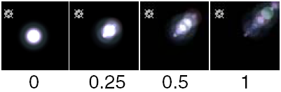

The amount that the hue of individual circles is randomized about the Flare Color. The Color Spread value has no effect if the Flare Color is not at least partially saturated (for example, not white or grey). The slider range is 0 to 1. The default value is 0.5.

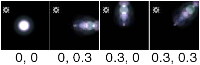

Controls the axis of the flare effect relative to the center of the image. If the light source moves, the flare appears to rotate through this point. The slider range is -1 to 1. The default value is 0.
The length of the flare effect relative to the light location. If Length is small, all circles overlap the light. If Length is large, the circles spread out across the image. The Length value has no effect if the Vertical and Horizontal values are both 0. The slider range is 0 to 1. The default value is 1.

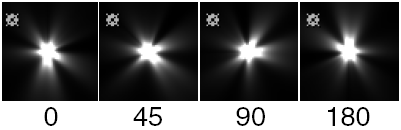

Rotates glow and fog noise and star effects (2D Noise, Radial Noise, and Star Level) about the center of the light. The slider range is 0 to 360 (degrees). The default value is 0.
The number of points on glow star filter effects. A Star Points value of 1 produces a comet-like effect. A non-integer Star Points value could render with a seam or hard line at the top of a star effect. The slider range is 0 to 10. The default value is 4.
Set the Star Points value to 1, the Star Level value to 1, and the Glow type to RAINBOW to produce a rainbow arch.

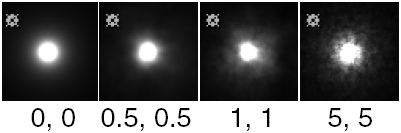

Scales glow and fog 2D noise in the horizontal (Uscale) and vertical (Vscale) directions. The slider range is 0 to 5. The default value is 1.
You can use Uscale and Vscale to create layered fog or tall flames. Animate the Uscale and Vscale values from high to low values to make the noise appear to fly apart like an explosion.

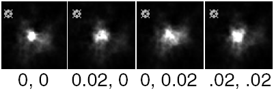

Offsets glow and fog 2D noise in the horizontal (Uoffset) and vertical (Voffset) directions. For example, you can animate the Uoffset and Voffset values to simulate smoke, rain, or snow moving past a light. Noise repeats after an offset of 1. The slider range is 0 to 1. The default value is 0.
