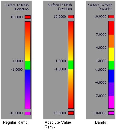

If this option is checked (default), the color scale updates automatically based on a range between zero and the maximum deviation from the last operation.
Maximum distance between the mesh and the collar surface shown on the color ramp. Areas on the mesh where the deviation is larger than this value are displayed in a solid color (red or purple). The default is 10.0.
Upper limit for the acceptable deviation between the mesh and the collar surface. Regions of the mesh where the deviation is smaller than this value are colored in green. The default is 1.0.
Where the value of the deviation is between the Acceptable Distance and the Ramp Distance, the mesh displays intermediate colors as shown on the ramp.
The Ramp Distance must be kept larger than the Acceptable Distance.
Turn on this option if you are not concerned with the direction of the deviation and simply want to view absolute deviation values.
Turn on this option if you want the ramp to display solid bands of color instead of slowly varying colors.
