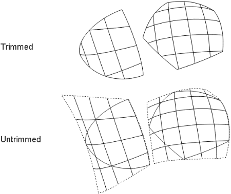

The N-sided tool does the following:
  1. Creates a normal (four-sided) NURBS surface that simulates a blend between the boundary curves.
  2. Trims the surface using the boundary curves to create the appearance of a surface with up to 8 sides.
Triangular surfaces created by N‑sided are not degenerate (that is, they do not have a zero-length side). The surfaces are only trimmed to appear triangular.
