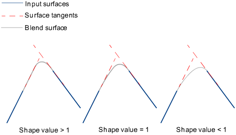

Side 1 Shape
Provides control over the “looseness” or “tightness” of the blend surface toward the first boundary. If the value is greater than 1.0, the result is a blend that fits tighter to the corner of the input surfaces; if the value is less than 1.0, the result is a rounder blend that fits closer to the edge of the first surface.
Side 2 Shape
Provides control over the “looseness” or “tightness” of the blend surface toward the second boundary. If the value is greater than 1.0, the result is a blend that fits tighter to the corner of the input surfaces; if the value is less than 1.0, the result is a rounder blend that fits closer to the edge of the second surface.

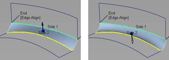

G0 blend with: left: no crown; right: flipped, crown value = 0.2
Drag the circle of the proportional crown manipulator to change the Crown Value directly on the model. The value adjusts in 0.005 increments. Use the left mouse button for adjustments, the middle mouse button for fine adjustments.
Flip
Flips the direction of the crown.
Click the arrow of the proportional crown manipulator to Flip the crown direction directly on the model.

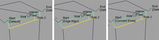

Flow Control

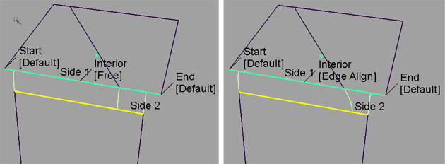

Start/Interior/End
Controls how the blend surface(s) edges (in the V direction) meet up with the edges of the boundary surfaces.
Edge align – The tool tries to colinearly align the blend surfaces’ edges or isoparms (for single surface) to the edges of the boundary surfaces in the V direction.
Connect ends – The edges of the blend surfaces meet the start and/or end points of the boundaries exactly.
Default or Free – The edges of the blend surface(s) (in the V direction) meet the boundaries at a 90 degree angle.
Clicking the labels on the model lets you cycle through all the possible values.
Possible flow control values for Start of blend
Possible flow control values for Interior of blend

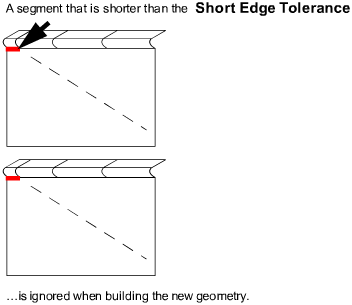

Short Edge Tolerance
In the case of cross-knot insertion, the system will not allow spans of a linear distance less than the Short Edge Tolerance.
