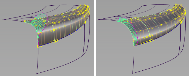

Form Factor
This parameter lets you adjust the shape of the fillet. It specifies the ratio between the lengths of the innermost and outermost CV arms of the hull in the V direction of the fillet. Values range from 0.1 to 2.0. The smaller the value, the sharper the bend in the fillet.
A G2 symmetric fillet with, left: form factor = 0.1, and right: form factor = 2.0.

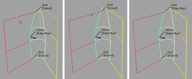

Flow Control
Start/Interior/End
Controls how the fillets edges (in the V direction) meet up with the edges of the boundary surfaces.
Note: You can only change the setting of the Start and End edge alignment if the corresponding Modify Range Start/End slider is set to its default of 0.0 or 1.0. If that is not the case, the option disappears from the control window and cannot be set.
Edge align – The tool tries to colinearly align the fillets edges, or isoparms (for single surface), to the edges of the boundary surfaces in the V direction.
Extend – The fillet is extended so that it reaches to the end of the longest boundary surface, at its start and/or end.
Default or Free – The edges (in the V direction) of the fillet meet the boundaries at a 90 degree angle.
Clicking the labels on the model lets you cycle through all the possible values.
Possible flow control values for Start of fillet
