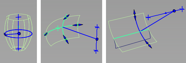

Side Glass – Displays the Mode option.
Mode
Specifies the type of side glass you are building:
Barrel – Creates a section of a surface of revolution through the specification of five points that define an arc of revolution and an intersecting arc, the barrel curve. This type of surface is useful for modeling vehicle side windows.
Helix – Creates a section of a surface of revolution through the specification of one or more curves, and two points that define an intersecting arc of revolution. This type of surface is useful for modeling vehicle side windows.

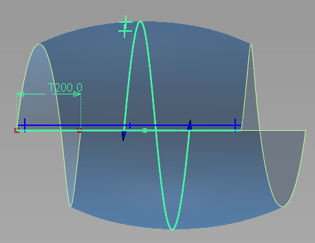

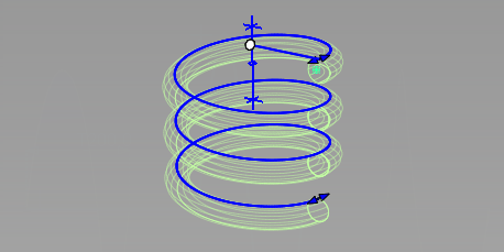

Pitch
Specifies the displacement of the curves (along the axis) over one complete revolution.
This option is only available when Surface type is set to Freeform or Side Glass in Helix mode.
Helix, Pitch of 200.0
Freeform, Pitch of 200.0

Start angle/End angle
Specify the angle between the start/end points of the arc of revolution and the barrel or helix curve. These values are also controlled by arrow manipulators on the model.
These options only apply to Barrel and Helix surfaces.
Curve start angle/Curve end angle
Specify the angle between the start/end points of the barrel curve and the arc of revolution. These values modify the extent of the curve. They are also controlled by arrow manipulators on the model.
These options only apply to Barrel surfaces.
