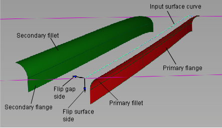

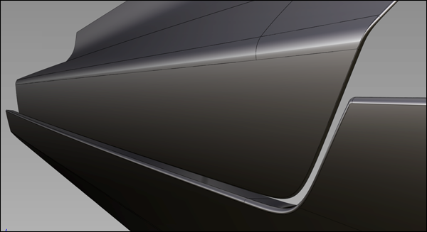

Creates the many surfaces that define a finished gap, along a set of tangent continuous surface curves, including the flanges (that define the edges) , the fillets between the panel and the edges, and an optional close-out surface at the bottom of the gap.
Example of a panel gap.
To build a gap within a panel surface, you need, at a minimum, one or more tangent continuous (G1) surfaces curves on the panel. Optionally, you can also build the gap between a set of G1 surface curves, and a separate set of surfaces. See Create panel gaps with rolled edges for more details.
As with the Fillet Flange tool, an imaginary "wall" surface is first built off the surface curves, to help define the primary fillet. (The wall is not actually added to the model.)
Instead of having explicit wall options like the Fillet Flange tool, Panel Gap uses the Primary Flange options to define the wall.
If the primary flange Type is set to Parting line, the wall uses the Primary Vector direction plus the Draft angle as the draft direction. If the primary flange Type is set to Sweep angle, the wall is based on the direction of the surface normal at the selected curve.
The primary fillet and flange are created in the same way as with the Fillet Flange tool.
The primary and secondary fillets can be either tangent (G1) or curvature (G2) continuous with the panel surface. The same control options found in other rolled edge tools are available: a Form factor slider, and the ability to specify either the Center radius, Tangent offset, or Both for each fillet.
By default, both Primary Section Type and Secondary Section Type are set to G1 Tangent.
The primary fillet is built between the panel surface and the (imaginary) wall. The location of the secondary fillet is calculated from the radius of the primary fillet, gap distance, and radius of the secondary fillet.

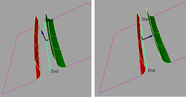

Center line – Centers the gap over the input curves.
Primary side – Builds the primary geometry at the location of the input curves and positions the gap on one side or the other.
Left: Center line. Right: Primary side

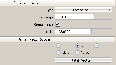

These options only apply when Type for the corresponding flange is set to Parting line.
X, Y, Z – Select one of these to specify a pull direction along that axis.
View – Select this option to specify a pull direction normal to the current view. The vector is not drawn in the view windows.
Picked – Selecting this option lets you specify the name of an existing vector in the Picked Vector field, or pick the vector in the view. This vector defines the pull direction.

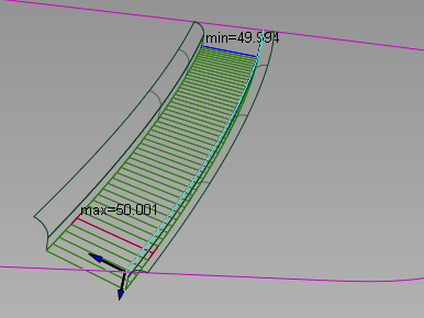

Turn on this option to show a deviation comb, as well as minimum and maximum deviation at the gap location.
Additional options appear to let you control the deviation locator.
Acts as a tolerance, and is most useful in the case of a constant gap width. If the gap is within that value of the requested Gap distance, the deviation quill is green, otherwise it is red.
Here Gap distance = 50.0 and Threshold = 0.1

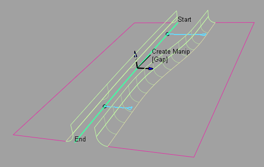

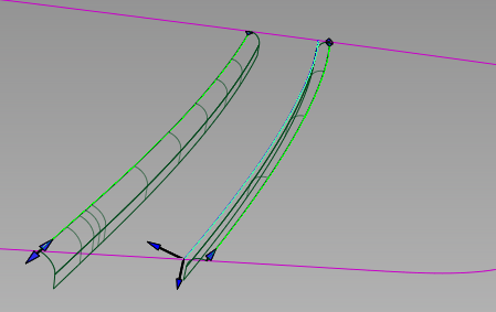

When Variable geometry is checked on, you can control the width of the gap, or the direction of the primary and secondary flanges by placing and adjusting manipulators along the gap.

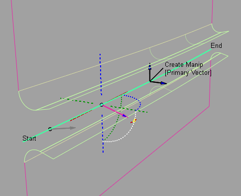

A label called Create Manip [Gap] appears on the model near the center of the input curve. Clicking on [Gap] toggles between [Primary Vector], [Secondary Vector], then back to [Gap]. This determines the type of manipulator that will be created when clicking the input curve. The behavior is the same as setting the Create Manip option in the control window.
Each manipulator consists of two handles, one at each end. Click on a handle to change its value (it turns white) or simply roll over it to see the value (it turns yellow). Hold
and click on a manipulator to remove it.
Only manipulators of the type indicated by the Create Manip label can be modified. Others are drawn in grey. The prompt line gives feedback while using the manipulator controls.
Gap manipulator
The gap widths between the edge of the panel and the first manipulator, as well as between the opposite edge of the panel and the last manipulator, are constant. The width between any pair of interior manipulator is interpolated.
Vector manipulators
. For both Primary Vector and Secondary Vector manipulators, the vector direction between the edges of the panel and the nearest manipulator remains constant. Between any pair of interior manipulators, the vector direction is interpolated.
