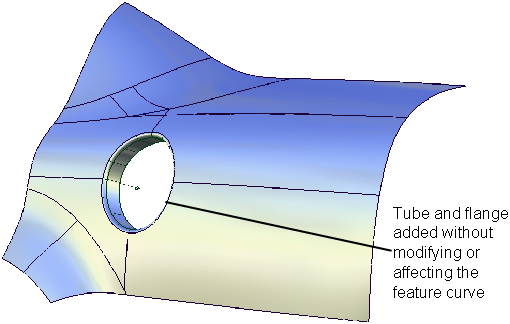

By using one or more of the following: edge, curve-on-surface, boundary edge, or iso-parametric line, the tool creates a tube that touches the selected geometry. The tool also creates a linear extension — a flange — on the tube. This extension can be defined by a sweep angle or a vector plus a draft angle.

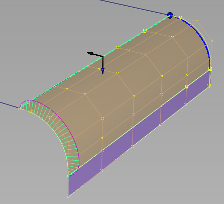

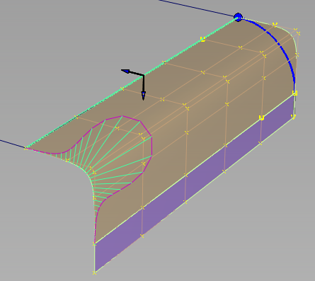

This parameter lets you adjust the shape of the tube while keeping either the Center radius or Tangent offset constant. It specifies the ratio between the lengths of the innermost and outermost CV arms of the hull in the V direction of the tube. Possible values range from 0.1 to 2.0.
In the example below, we specify the tangent offset to be 60.0. Changing the form factor causes the center radius to vary.
Form factor set to 0.1, creating a small center radius and a sharper bend in the tube.
Form factor set to 2.0, creating a large center radius and a more circular tube shape.
