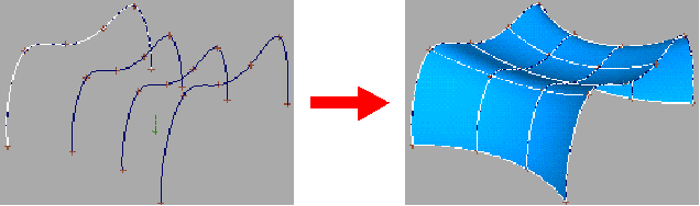

Creates a surface by “skinning” a NURBS surface across cross-section curves.
