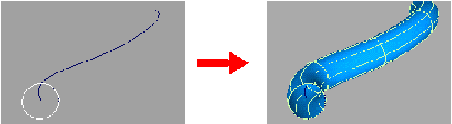

Creates a new surface by extruding a generation curve along a path curve. Normally used to make tubular objects with symmetrical cross sections.
Tube – As the profile curve sweeps along the path, it pivots to maintain the same angle to the path curve.
Flat – As the profile curve sweeps along the path, it maintains its original orientation.
Caps can be created at the ends of the surfaces if the extruded objects are closed planar curves.
