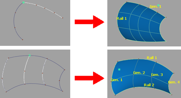

Generation Curves
1 – Sweep one generation curve along the rail curves.
2 – Blend between a start and end generation curve along the rail curves. Use the Gen. Blend Value slider to control the midpoint of the blend.
2+ – Blend between a series of generation curves along the rail curves.
Rail Curves
The number of paths to sweep the generation curve(s) along: either 1 or 2. The default setting is 2.
Setting Rail Curves to 1 is similar to using the original Swept tool (in Alias 9.5). Setting Rail Curves to 2 is similar to using the original Birail tool.

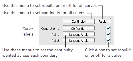

Continuity table
The Continuity Table displays one row for each boundary curve involved in the rail operation.
  • Use the pop-up menu next to each curve to set the level of continuity you want across that curve.
  • Use the Continuity pop-up menu above the table to set the continuity you want for all of the curves at once.
  • Click the checkboxes at the end of each row to rebuild the curves to reduce data and improve parameterization.
  • Use the Rebld pop-up menu to set rebuild on or off for all the curves at once.
    For example, before creating the surface, rebuild the first rail curve, second rail curve, first generation curve, and/or last generation curve. (To rebuild interior generation curves, use the Rebuild Interior Gen. Curves option below.)
    This can improve the parameterization and reduce the complexity of the new surface when the curves are complex.
    Rebuilding curves can also remove multi-knots and reset the weight of all CVs in the rail curve(s) to 1. This is necessary for rail curves with multi-knots or CV weights.

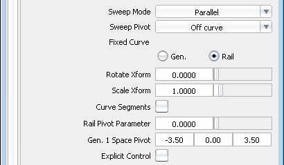

Sweep Pivot
This option is only available when Rail Curves is 1.
Sweeping involves two pivot points:
  • The point on or off the generation curve (the Generation Pivot) that stays on the rail curve as the generation curve sweeps. The generation curve rotates around and scales from this point.
  • The point on the rail curve (the rail pivot) that corresponds to the generation curve before it is swept. In other words, the part of the surface corresponding to this point on the rail curve will have the exact cross section of the generation curve.
You can have Rail Surface set the pivot points automatically (as in Extrude), or set them manually for the generation and rail curves.
Off Curve – Set the pivots to a specific parameter on the rail curve and a 3D point in space for the generation curve.

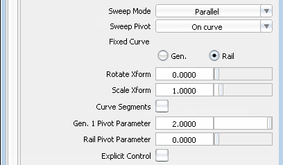

On Curve – Set the pivots to specific parameters on the two curves.
  • Use the Gen. Pivot Parameter and Rail Pivot Parameter sliders to set the parameters for each curve.

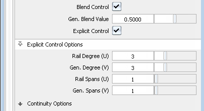

Blend Control
Enable the Gen. Blend Value slider to control the midpoint of the blend between the two generation curves.
This option appears when Generation Curves is 2.

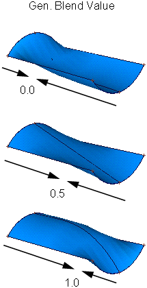

Gen. Blend Value
The percentage of the distance (from 0 to 1) along the rails where the influence of both generation curves is equal.
For example, a value of 0.5 (the default) blends the two curves equally, so that the halfway point of the blend occurs at the midpoint of the rails.
A value of 0.25 places the halfway point of the blend 25% of the distance along the rail curves, hence giving more influence to the second generation curve. Conversely, a value of 0.75 would give more influence to the first generation curve.
The values 0.0 and 1.0 still blend the two curves a minimum amount.

This option determines which of the curves will be moved in order to make the two pivot points coincide before the sweep. This in turn controls where the new surface will be created.
This option is only available when Rail Curves and Generation Curves are both 1.
Gen. – Keep the generation curve fixed and move the rail. The new surface is built beginning at the generation curve.
Rail – Keep the rail fixed and move the generation curve. The new surface is built along the rail curve.

Explicit Control
Turn on this option to open the Explicit Control Options section that allows you to explicitly specify the degree and number of spans of the rail surface in both the U and V direction.
These options are available only when Explicit Control is on.
Rail Degree (U)
Degree of the rail surface in the U direction (along the rail curves).
Gen. Degree (V)
Degree of the rail surface in the V direction (along the generation curves).
Rail Spans (U)
Number of spans of the rail surface in the U direction.
Gen. Spans (V)
Number of spans of the rail surface in the V direction.
