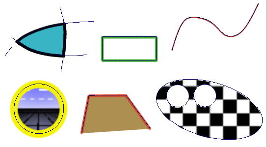

A shape is a way to create a precise image that you can easily modify.
A shape’s shape is defined by a curve or set of curves. You can create a shape from any Alias curve, including curves-on-surface and surface edges. A shape also has fill and outline properties.
After you create a shape from a curve or set of curves, any changes you make to the curves (for example, scaling a curve or moving an edit point) will update the shape.
You can then use the original curves to build surfaces, and any changes you make to the curves will automatically update both the sketch and the model.
